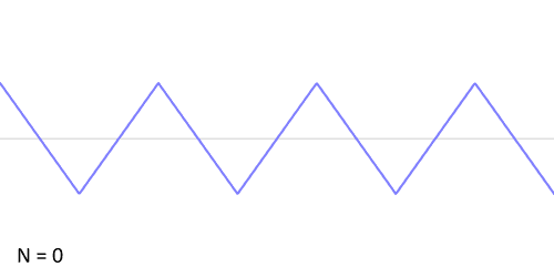

No, the peak is assymetric (see black line below) and only goes from node to node in a Fourier model analysis of a string fixed at both ends. It is just the sum of the overtones drawn from superposition principle. See the coloured overtones below.

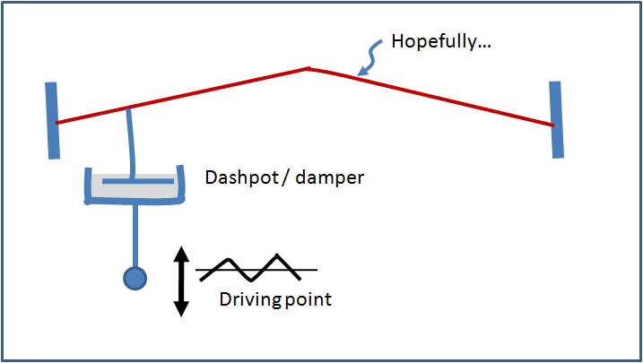

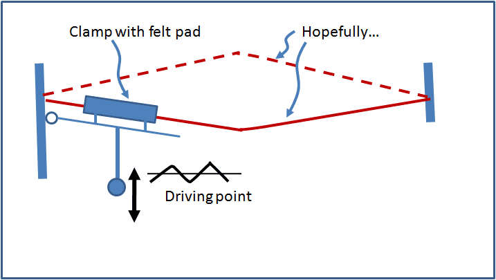

Hammering a string can impress a pulse shape that's not related to the modes of the string (as when it's plucked) so that's another reason why the Attack sounds the way it does.
This may be a bit tangential from the OP.
And yet...

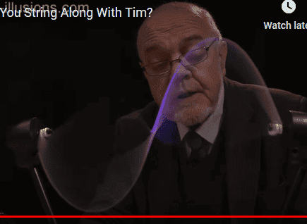

In the video link I posted in post #26
Swamp Thing said:
-Video-
if you watch the video from 04:14, the sine wave is flipping sign about twice a second, i.e. ##\pm sin(x)##
This can't be a camera (sampling) artefact, I think?
If not... well, normally one would expect the envelope of the string to be a surface of rotation, at least when it's in steady state. But here you can see that the string seems to be constrained to, say, the upper half wave on the left and to the lower half wave on the right. This state lasts for about half a second, and then it flips to being the other way round.
Could it be that the LEDs are cleverly synchronized with the motor to achieve this effect, perhaps changing phase by 180 degrees every half second? This might work if each set of LEDs illuminates one half of the string... ?
Here is a capture from the video. One objection to the LED theory is that there is enough ambient light to see Tim's face, so even when the LED is off, we should be able to see the string, at least faintly, in the positive left hand side.
The visible region is from around ##-0.2 A sin(x)## to ##-A sin(x)##

The polarisation of the string is rotating (as in the model with the string). That's normal for a vibrating string as there's nothing to keep it in one plane.

Could it be that the LEDs are cleverly synchronized with the motor to achieve this effect, perhaps changing phase by 180 degrees every half second? This might work if each set of LEDs illuminates one half of the string?
The device does have a built-in LED strobe light. Other youtube videos of this 3D Standing Wave Machine mention it has adjustments for stroboscopic effects (flash speed, pattern select, and pulse control). Unfortunately, the description does not specify whether some of these stroboscopic effects are cleverly synchronized with the motor.
