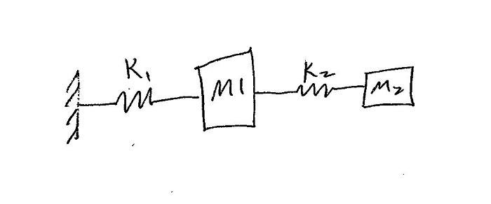

I wanted to know if there were any real-life(by "real-life" I simply mean something with springs and blocks and wedges and what not) examples where these equations could be applied instead of just a hypothetical particle undergoing 2 hypothetical SHM's. the first thing that came to my mind was something like this
(assume the two springs have a different value of spring constant(k) say ##k1## and ##k2##)
then the equations of motion are:
$$x_1 = A_1 sin(\sqrt{\frac{k_1}{m}} t)$$
$$x_2 = A_2 sin(\sqrt{\frac{k_2}{m}}t)$$
but I am unsure as two how to (or if I even can) proceed to prove that this the composition of SHM's in the same direction. from the above equations of composition of SHM's the resulting amplitude of the motion should be ##A_1+ A_2##
I didn't have any problem with the composition of SHM's in the perpendicular direction.composition of two SHM's
What you have drawn is just an Harmonic Oscillator with spring constant ##k_1+k_2##. Please reconsider your question.
I thought maybe it could be considered to be a composition of two separate SHM's but I realize now that's not the case.
so I am still looking for some kind of example of a composition of two SHM's in the same direction(if that's even possible in real life)
Sure there are. For small oscillations a double pendulum is one that comes to mind. Two masses connected wall-spring-mass-spring-mass are what you had in mind I think. Such arrangements show up (more or less) in auto suspensions for instance.
I don't see how there is a composition of two SHM's in the same direction in a double pendulum(I assume you mean one pendulum attached to another(its a chaotic system I don't think that it perform SHM for small angles, so it can't be a composition of two SHM's)) now I am pretty confused is wall-spring-mass-spring-wall a composition of SHM's in the same direction or not I tried to prove it in my original post.
For small oscillations.
Perhaps you need to define "composition " more precisely. I don't know what you are looking for.

Try a search with search terms tuned mass damper. Lots of good examples in the first page of hits.

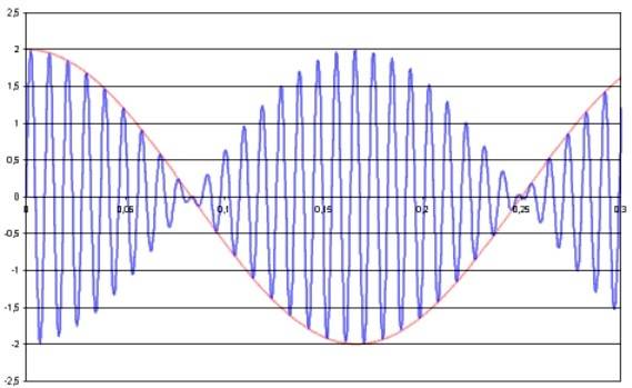

Tuned mass dampers have a spring mass system attached to a larger spring mass system. Both spring mass systems are tuned to the same frequency. The resulting system has two masses and two springs, and has two separate natural frequencies. One of those natural frequencies is higher than the original natural frequency, the other is lower. The difference between the two natural frequencies is proportional to the ratio of the tuned mass to the mass of the original system. The springs and masses are connected as follows, where the primary system is K1 and M1, and the tuned mass is K2 and M2:
Since the resulting system has two natural frequencies, the phase relation between the two masses is variable. Search beat frequency to learn more. Example of beat frequency from the Wikipedia article:
This is exactly the response of a system with an undamped tuned mass damper.
In this scenario(wall-spring-block-spring-block) I think there is no straightforward composition of two SHM's and to solve for the amplitude and phase of the oscillations produced is quite complicated.
I think what conclusion I have come to is that there are no mechanical systems where two SHM's can directly be composed into a single one(unless that's possible in a tuned mass damper but the equations of motion of the two blocks are quite complicated and I am unable to see how we could compose two SHM's in this case maybe if someone could set up the equations of motion(I mean for ##x(t)## ))
I have not yet studied oscillations in electrical circuits yet but from what @tech99 said I think the concept of composition of two SHM's in the same direction will be used in oscillations in an electrical circuit.
The reason why I asked if there were any mechanical systems that could be considered to be a composition of two different SHM's was because the process of composing two SHM's is stated under the mechanics part of my textbook and I thought maybe it could be applied to some kind of mechanical systems. All the problems based on this section never mention any real system, they simply just mention the equations of two SHM's(##x(t)##) and ask questions related to composing them into a single one.
if someone could help compose the equations of motion of a spring-mass damper by using the method mentioned here composition of two SHM's then that would be amazing!
