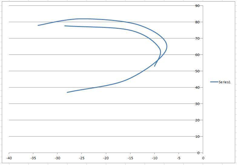

I am hoping you all could help me. I have been accused of a felony based on these tire marks. I did not make these marks! I do not even think my truck is capable! I am wondering if there is a way for the law of physics to prove this. I am posting all of the information I have that I thought might be relevant. I will get (or at least try) any other info needed. Please help me!
It is a single cab 4x4 diesel pickup, weight is 5820 lbs. Distance from center of L front tire to center of R is 67 inches. Wheelbase is 137 inches.
The marks as recorded by the CHP:
All measurements were taken at right angles to the station line.
Item 1: Centrifugal/acceleration skid mark from V-1, increasing in width from its starting point.
Begins: 28 feet of station point 0+37
Continues: 15.5 feet left of station point 0+45

I took some physics but I don't remember a whole lot. Here is my thought process:
Those numbers are in feet based off the predetermined "station point" which is basically some random point they chose to base their measurements on.
So if the station point is 0-0 then
x= -22 y=37
x= -15.5 y=45 etc...
If you load them into the graphing calculator you can see what the marks looks like. I was hoping to be able to say that it is impossible for my truck to be able to make those marks based on size alone. They are circular "doughnut" marks. My truck does not make turns like a small car (ie: I have to swing wide to make it into my driveway).
I thought there would be a way to exclude my truck simply because it is too big to have made these marks.

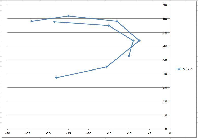

I don't know man. Those are pretty big donut marks. I mean, it's 40-50 ft between some of your points.
I don't know if it will be of any use but here's a couple of informative document on skid mark analysis and http://www.harristechnical.com/articles/skidmarks.pdf.
Thanks for taking the time Drakkith. That is what I was coming up with too so I thought I was doing something wrong. According to what I graphed out it would take a bus to have made those marks.

I've had a go at plotting it using Excel. Don't rely too much on the smooth version as not enough data points.

I thought I would update you guys if anyone is still interested. It wasn't looking too good for me so I ended up hiring a accident reconstruction expert and I finally got the report. My case is still pending so my fate is still unknown but I hope that this enough to prove that I am not the one that is lying. What ever happened to innocent until proved guilty?
The expert went out to the scene and the marks were still there along with the paint marks from the CHP “investigation.” I then met him in a parking lot and we did a bunch of bunch of “tests” and he took hundreds of measurements with his fancy laser. He was able to prove that my vehicle was not capable of making that tight of a turn. The report is long but he made several points that excluded my vehicle from doing what the so called witnesses claimed.
