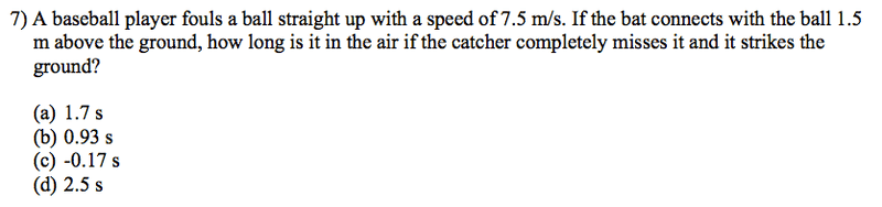

So I'm given...
In the y-direction
vo = 0 m/s
vf = 7.5 m/s (is the speed of the ball thrown straight up)
g = -9.81 m/s2 (when it falls back down)
yo = 0 m
yf = 1.5 m (at this height above the ground, the bat connects with the ball)
t = ?
I tried doing this...
yf = yo + vyot + (1/2)gt2
1.5 = 0 + (0)t + (1/2)(-9.81)t
1.5 = -4.905t
0.30581 = t
Help?
riseofphoenix said:
So I'm given...
In the y-direction
vo = 0 m/s
Projectile motion starts just after the ball leaves the bat. So, the initial velocity is not zero. The final velocity would be the velocity the ball strikes the ground (not given).
Similarly, think about the initial and final values of y.
TSny said:
Projectile motion starts just after the ball leaves the bat. So, the initial velocity is not zero. The final velocity would be the velocity the ball strikes the ground (unknown).
Ok... So
vo = 7.5 m/s (initial speed of the ball when thrown straight up)
vf = ____ m/s (the final speed when the ball strikes the ground)
yo = 1.5 m
yf = 0 m (at this height above the ground, the bat connects with the ball)
t = ?
Like that?
Yes. Good.
TSny said:
Yes. Good.
0 = 1.5 + 7.5t + (1/2)(-9.81)t2
0 = 1.5 + 7.5t - 4.095t2
0 = - 4.095t2 + 7.5t + 1.5
Quadratic formula:
[ -b ± √(b2 - 4ac) ] / 2a
= [ -7.5 ± √(7.52 - 4(-4.095)(1.5)) ] / 2(-4.095)
= [ -7.5 ± √(56.25 +24.57) ] / -8.19
= [ -7.5 ± √(80.82) ] / -8.19
= ( -7.5 ± 8.989 ) / -8.19
= ( -7.5 - 8.989 ) / -8.19
= -16.48999444 / -8.19
t = 2.013 s
What did I do wrong??
Looks like just a slip. Half of 9.81 is not 4.095
Oh yeah...i just realized that..the answer is supposed to be A :)

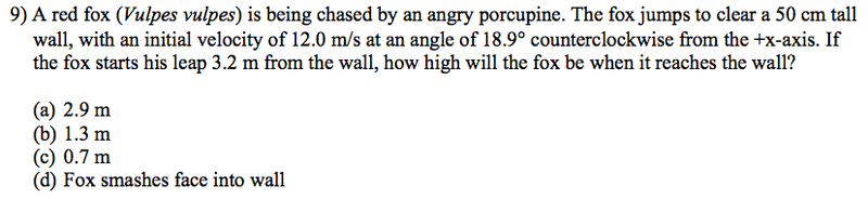

Can you help me out with one more?
I tried doing...
a2 + b2 = c2 after making my triangle...
3.22 + b2 = 122
b2 = 144-10.24
b = √(133.76)
b = 11.56
And then I tried doing
12*sin (18.9) = 3.89 m
Don't you think gravity might come into it somewhere?
