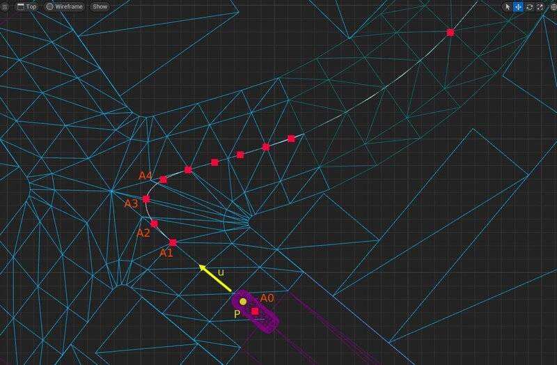

I'm developping a traffic simulation on Unreal Engine
Good morning ,
I managed to simplify the physics of my car with only the centrifugal and traction forces. If I'm in control of it, the realism is acceptable for a city builder. On the other hand, I encounter a problem when the car follows an array of points.
The path of the car on my graph consists of an array of position vectors A[],
I'd like the steering wheel to rotate realistically based on the car's position and rotation relative to each A .
The unit vector u is always in the same direction as the front of the car, P is located between the 2 front wheels.
The problem with my algorithm is that on certain portions, the car tends to zigzag.
Any idea please to remove this zigzag effect?

Sorry i forgot to show you the algorithm :
Code:
Every frame if CarIsMoving = true :
If DegreesAngle(A[i] – P, u) >= 90
we go to next A[i], so
      i = i+1
 Else,
DeltaSteeringAngle = DegreesAngle(RotateVectorAroundZAxis(u, SteeringAngle), A[i] – P)/15
SteeringAngle = SteeringAngle + DeltaSteeringAngle

I update the Thottle property everyframe, but car speed is bounded by every A[].SpeedLimit. In fact
A[] is a PathData struct array storing Location, Tangent, SpeedLimit properties

these tangents are simply tangents on every waypoint. I use them to correctly orientate the car in the correct direction when i spawn it at a specific A[0]
If you have two points with tangents, then they define a circular arc. The vehicle orientation can change as it moves in single frame steps along that arc, and the steering wheel position can be determined by the radius of curvature of the arc.

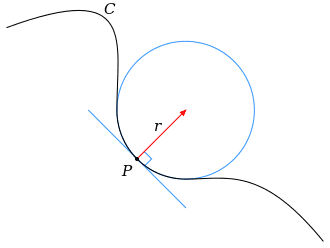

Then do it without forces:
- Place the center of the back axle on the path at some point P and rotate the car such that the back axle is perpendicular to the path at P.
- Orient the front wheel axles, so they point to the center of curvature of the path at P. Note that for a straight path the center of curvature is at infinity, so you might need a threshold to deal with that numerically.
https://en.wikipedia.org/wiki/Ackermann_steering_geometry
https://en.wikipedia.org/wiki/Osculating_circle

As suggested i will have to use osculating circles:
What do you think is the best optimization/realism compromise?
Should the car's OsculatingCircle be updated every frame from its trajectory spline? Or is it realistic enough to bake 1 OsculatingCircle per checkpoint, and interpolate car position / front wheels rotation / car rotation between them?

Try it and compare. Computing the circle approximation from 3 points on the path should not be that computationally expensive. Or there might be an analytical formula for the type of spline you are using.
Hi all, finally i computed osculating circle every frame.
Thank you very much for giving me this solution. Not only this method offers a clean car behavior, but also it is more optimized than using Newton's 2nd Law by following a array of points.
