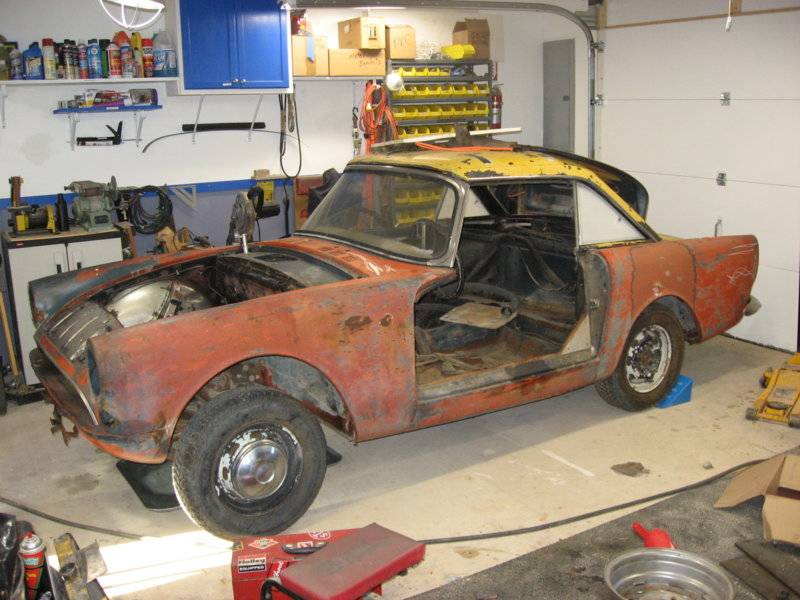

I am building a 1967 Sunbeam Alpine and installing a Ford Lima 2.3 modified 4-cylinder with an A4LD overdrive automatic. At 75 I still love to drive but this is for long trips. That sounds crazy for a car with an 89 in wheelbase, but it is what I am doing.
The rear leaf suspension will be dismantled and rebuilt adding gas shocks and Teflon between the leafs. My question relates to Rubber or Poly bushings. I installed Poly bushings on my 65 Mustang and it helped overall handling on wavy roads. However, they seem to add road-feel to the driver, that is a little more than I want in a short wheel-base daily driver sportscar. I am not going racing, but may drive it across the US.
I have heard use polyethylene only in the front of the spring, while others say only in the rear, because the front transmits load to the chassis, right under the seats. I plan to use poly in the front sway-bar only, with rubber everywhere else. Control is my goal for a street car without the loss of too much comfort. For 50 years I built Street Rods but this is my first sportscar. Thanks.

ifin you want smooth rude go with stock bushings. Engineers spent thousands of hours and millions of dollars developing a good compromise between comfort and performance. If you want maximum performance go with metal bushings. The in between is poly bushings but as you have found out, they ride a little harsher. Put in the stock rubbers as they will out live you and me on this ride! I been bending wrenches on race cars since 1964.
