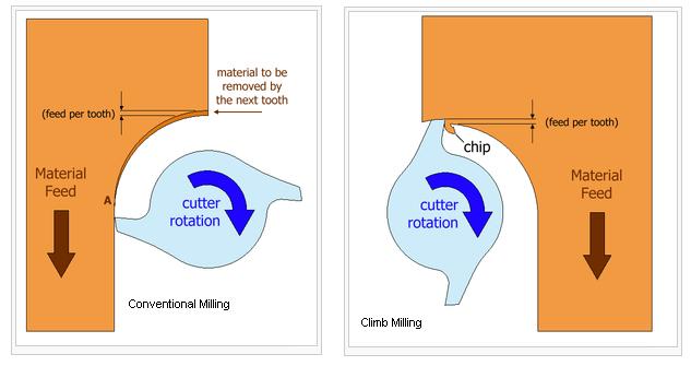

for instance : Why is it that climb cutting for a mill is preferable than conventional cutting (the physics behind it). if someone can give me a good intuition on this it would be nice, after reading countless google results and wikipedia, all I get is that conventional cutting have poor finishing while climb cutting doesn't, but what is the physics behind it?

Here's what I was told: With conventional milling, the cutter will try to dig itself into the part. With climb milling the cutter is trying to push itself out of the part. In the latter case the end mill has a tendency to remain pushed slightly away from the surface it has just cut as it "climbs" onto the next bit of surface it is going to cut, so it doesn't rub against it and mar the finish.
that makes sense, qualitatively i guess, so you are saying the endmill pretty much is bouncing around the material "cut, bounced off, cut bounced off" so that's why it has better finishing? and the reason why this happens to only conventional cutting is because there are more resistance/material "behind" the trajectory of the cutter?
I guess that makes sense.So why is it that climb cutting require more force? my TA just told me is because the cutter is cutting more material onset of the cut so it is like a collision that needs higher force to steady the velocity of the endmill. But if the force is a function of how much material is being removed per second, i really don't see how the same could not be said about conventional cut.
UNLESS, the force is actually a function of rate of change of material removal rate. then it would make sense.
I think another way to explain it is; on a conventional cut, the cutting edge makes contact directly opposing the motion of the workpiece. On a climb cut, the cutting edge makes contact perpendicular to the the line of motion of the workpiece. This tends to push the tool bit away. Also, I think the linear distance traveled by the cutter while in contact with the material is half that of the conventional way.
The climb cut is slower and removes less material. But since it provides the nicest finish, it should be done on your last pass. In my experiences, aluminum looks like crap if not climb milled.

No, there's no bouncing at all. The side cutting edge of end mills has a spiral configuration. That eliminates sudden pressure differentials. It is continuously flexed away from the part. The point of contact travels vertically from the bottom to the top of the endmill and the next cutting edge should engage before the previous one is removed such that contact is continuous.
The kinds of cutters they use on horizontal mills might experience the kind of "bouncing" you describe on a shallow cut, but I never worked on a horizontal mill and couldn't say.

Ah, good idea! A picture.
I had the same experience with aluminum: a conventional cut leaves an almost fuzzy finish. The same is true of steel, but it's not as bad.

wait, what tends to push the tool away? isn't the cutting edge always experiencing a force from touching the material? I heard that climb cut actually require more force because the onset contact require more force to steady the endmill?
also I am working out the geometry/math right now to show the linear distance travel is half of that of the conventional cut (if this this true that means the max chip width of the climb cut is actually half of that of conventional cut?)

forgive me but all these time i was imaging a flat blade cutter with sharp cutting the material (not spiral, but like a straight boss extrude in outside of the page)...well that changes everything, everything seems to make much more sense now, let me go process this.

Let's say a 1" diameter mill is spinning at 1 rev/s and your feed is 1 in/sec. The mill bit will travel a linear distance of 3.14 in/sec. So total distance of material passed per second will be:
Conventional cut: 3.14 +1 = 4.14"
Climb cut: 3.14 - 1 = 2.14"
Or am I missing something?

Climb milling. On the right. As the cutting edge pushes into the part the end mill is pushed away from the part.
In the picture of conventional milling you have to envision the cutter further along in its rotation to see that as it pushes the material away from the part the cutter, itself, experiences a force toward the part.
The illustrations are of a two-flute endmill. Both effects will be greater with a four-flute end mill.
