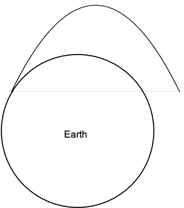

kuruman said:
If the projectile is stays near the surface of the Earth which is approximated as flat, it will return to the same height from which it was launched. Give it more initial speed and it will land below the horizon. Give it even more speed and the Earth will curve away from it and the projectile will go into orbit (see picture).
That’s not really how it works though. Any bound orbit (ie, excluding escaping solutions) starting at the Earth’s surface will return to the Earth’s surface simply by virtue of the orbit being an ellipse. In order to achieve an actual orbit above the Earth, additional changes of velocity that are not due to gravity (eg, by rocket boosters) is necessary.
Likes russ_watters and Chenkel

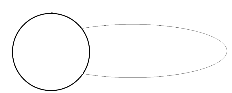

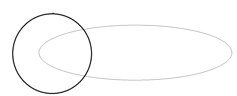

That picture looks wrong. It starts nearly tangent to the Earth's surface and ends nearly tangent to a larger radius. You can't get that behavior with an conservative inverse square central force.
It looks like a parabola with a vertical axis where an ellipse with a diagonal axis would have been correct. Cobbling up a better shape with mspaint, shifting to a horizontal axis and eyeballing to figure out where the foci live, I get a sub-orbital trajectory:
Note that since an orbit under an inverse square central force is a closed figure, it follows that an object projected from the Earth's surface at less than escape velocity will have an orbit that intersects with the surface of the Earth.
Edit: There are conservative central force laws that could produce the tangent behavior that was identified. For instance, one with a potential well at one radius surrounded by potential hills above and below.
