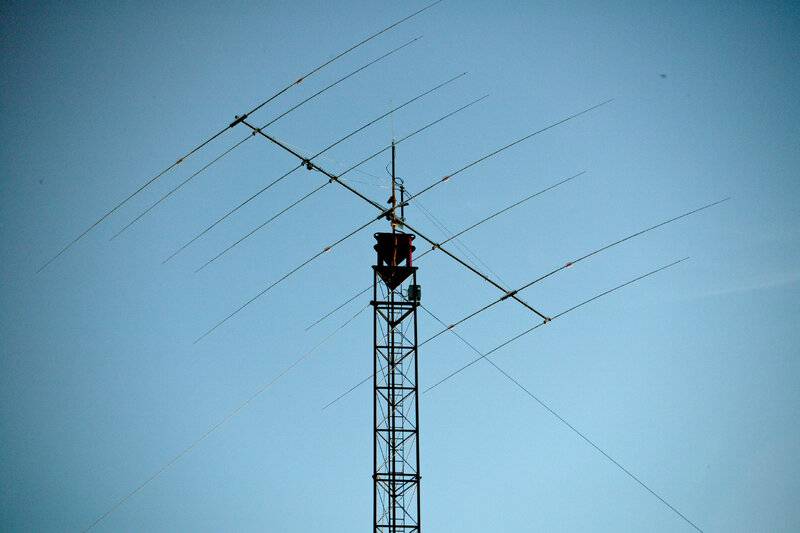

Took a walk around the block today and found a neighbor on the street behind mine who has something that looks like this:
It looks new and well-maintained. Hoping it's a HAM. Gonna head over tomorrow with some sort of freshly baked sweet thingy and try to make friends hoping that he will be excited to teach as I am to learn about how to optimize using the spectrum analyzer and how to de-RF my house.
It's gonna be a cold knock.
Who wants to give me advice on how to make fast friends with a HAM?
Why should we? You have repeatedly ignored our advice (most recently from @russ_watters ) to describe the symptoms, and are now ignoring our advice to locate the source before blaming anyone.
