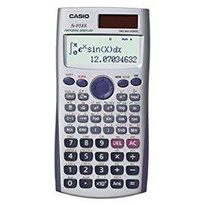

I have a TI-89 from my college days, and I also bought a Casio fx-115ES scientific calculator which is allowed to be used in the FE exam. I like both of them just fine.
The TI-89 is an excellent calculator, mainly because it's pretty much fully programmable and can do anything you have the need to do (on a calculator at least). It also has a good display for equations and graphing. I have used it for everything from symbolic manipulation to linear algebra to control systems analysis. These days I use MathCAD more than the 89, but it's there when I need it. A really nice thing about the TI-89 is the wealth of free programs available for it; check out http://www.ticalc.org/pub/89/".
The https://www.amazon.com/dp/B000A3IAHM/?tag=pfamazon01-20 is a very competent scientific calculator, with a "natural notation" multi-line display, scientific/physical constants, unit conversion, matrix and vector math, and algebraic equation solving. It's cheap, and works fine if you're just crunching numbers and converting units here and there.
In the end, a tool such as a calculator is only as effective as the person using it... In other words, read the manual.
Thanks. Can either of these handle exponents greater than 99? Mine returns errors for any exponent of x^100 or greater. Also, if there's a number with a bunch of zeros and then a couple digits, like 1.20000000000000000000006543, it will just display 1.2. Can these larger display calculators handle the extra zeros?

The TI-89 can, The Casio can't.
It depends on the context, but the TI-89 is a better bet. I'd like to mention that before you throw a caluclator our for not handling that, do you really need to do calculations with 30 significant digits? I rarely do calculations with more than 6...
