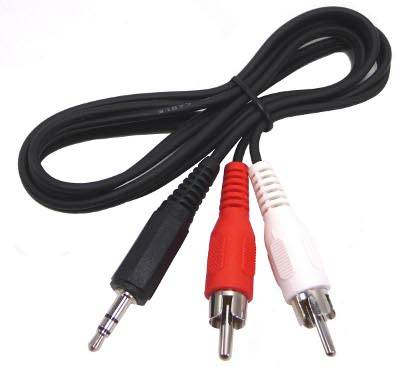

Your PC, as noted by others, can record from mic or line-level input -- if your radio receiver has a small-plug headphone output, you can connect it directly to the mic input on your PC. The PC may have a "line" input, and your receiver may have line-level (30 dB) output. If your radio set has RCA-type outputs (also 30 dB line-level -- NOT the speaker outputs), you might need something functionally equivalent to one of these:
I got that image from here, where you can read a good explanatory article. Please note that you'll have to configure your PC's recording capability for maximum ADC (analog-to-digital conversion) sampling rate to get the best audio fidelity. Once you have your recordings saved as MP3 or MP4 files (or in another to-you-playable digital format), you can burn them to optical media.
That will allow playback on PCs, but won't necessarily allow the recordings to be played back on regular CD or DVD players. To do that, you'll need some further file-packaging steps. A simple way to create regular audio CDs from MP3 files using Windows Media Player is explained in this article.
