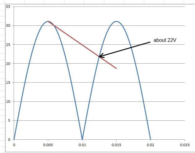

I have an unregulated power supply circuit consisting of the following:
Transformer, 10:1 ratio, 230VAC rms 50Hz incoming voltage
Full Wave Bridge Rectifier
Filter Capacitor, 1000μF
Load - Resistor, 25Ω
Find the following:
1) RMS & peak voltage across secondary winding of the transformer
2) Peak voltage across the capacitor
3) Peak to peak and rms ripple voltages
4) Load d.c. voltage & current
I am not after answers - just guidance & a push in the right direction. I want to learn, rather than just be told. The real problem I tend to have is confidence that I am doing the right thing. This applies to my answers for 2,3 & 4. Apologies if I have missed any information/not set out the query correctly!
For 1) V2/V1 = N2/N1
For 2) VL pk = Transformer secondary V (V2) - 1.4V (V.D. due to rectifier)
For 3) Vr = IL/fC (remembering that the frequency will be double that of the incomer, as it is bridge rectifier)
For 4) To be determined
1) V2/V1 = N2/N1. V2/230 = 1/10 . Therefore, V2 = 23V rms or 32.5V pk
2) VL pk = V2 - 1.4V. 32.5 - 1.4 . Therefore, VL pk = 31.1V pk
3) Assuming Vdc = VL pk , approx value of IL = VL/RL. Therefore, IL = 1.24A
Vr = IL/fC . Vr = 1.24/(100 x (1000 x 10^-6)) . Therefore Vr = 12.4V pk
4) I am yet to attempt number 4 or convert 12.4V to RMS, as I feel my answer for 3 is completely out - the ripple voltage seems too big.

It looks as if 1000uF is nowhere near enough, at it gives a time constant with the load resistor of about 2.5 cycles. It would be better to be ten times that value.

Looks like you're doing okay for (1) and (2).
When the simple approximation method for ripple (based on constant load current) yields a value that's an appreciable chunk of the total output voltage you know that it will be an overestimate as the discharge current will have dropped significantly between the start and end of the capacitor discharge.
You can get a better value by looking at the exponential RC discharge curve. Again there are different levels of accuracy you can obtain based on what approximations you're willing to make. Assuming that the capacitor discharges from one voltage peak until the next voltage peak is one level of approximation. Finding the actual intersection of the capacitor discharge curve and the rectified AC curve as it returns to peak is better, but when you're dealing with curves that are a mix of exponentials and sinusoids you need to be ready to solve graphically or via numerical methods.

I think you are doing everything correctly.
Looks like the problem is designed to have large ripple to highlight that the approximation method is only accurate when the ripple is small.
Another approximation method you can use is to calculate dv/dt = I/C (assumes constant current)
Then plot the dv/dt line over the rectified sine wave.
Read off where it crosses the next peak (about 22V in this case).
So the ripple is 31-22 = 9V pk to pk by this method.
In case it's not obvious where I got dv/dt=I/C from...
Q=VC ("Queen = Victoria Cross")
dQ/dt = Cdv/dt
dQ/dt = I
I = Cdv/dt
dv/dt = I/C
Good Afternoon Everyone,
Many thanks for all of your input so far - it has been extremely helpful. I have been stuck in a bit of rut with a couple of these problems recently and this has given me a bit of confidence going forward.
Based on the use of the approximation Vr = IL/fC, I end up with a result of 12.4V pk to pk. To find the rms value, I assume that I carry out the following:
0.5 x 12.4V = 6.2V pk . Then 6.2V/sqrt2 = 4.38V rms . Which gives me the two answers required for Q3.
For Q4. - Load d.c. voltage and current
Load d.c. voltage = V pk - Vr pk
Vdc = 31.1V - 6.2V . Therefore Load d.c. voltage = 24.9V
Load d.c. current = Load d.c. voltage/Load resistance
Idc = 24.9/25. Therefore load d.c. current = 996mA
I hope this is on the right path?
Thanks again!

Unless the curve is a sinusoidal the rms value won't be given by the peak/√2 . The ripple has more the shape of a sawtooth. Check out the Wikipedia article on rms.
+1
An RMS value is essentially an average. You might decide the ripple is like a triangular wave of height 12.4V. The average height of a triangle is it's area divided by the base.

Based on the information above, would it be reasonable to assume then that the discharge period is approximately equal to the total period, therefore creating the sawtooth shape?
If so, this then gives the rms value as: peak/√3 ?
Repeat CWatters' drawing using the values from your exercise
