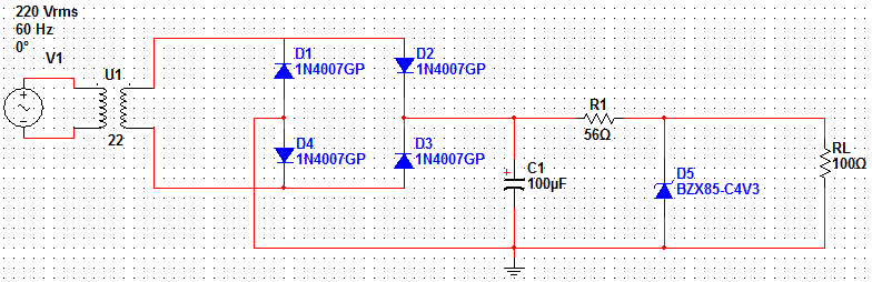

The following image is for my final AC--->DC converter design:
When I measure the output voltage at the load using a built-in multimeter, it displays an exact peak value of 4.3 V, which is the required output I was tasked to get by my lab instructor, but when I use the Oscilloscope to see the output wave form, it looks a purely straight line, only with a small variation in the displayed value extending from 4.268V to 4.317V. Is this normal?
The smoothing capacitor C1 is charging and discharging on each half cycle of the AC voltage. So the voltage across C1 will not be constant. A "real" zener diode is not a perfect voltage regulator, so a small variation in the voltage would be expected.
Put the oscilloscope across C1 to see how much the voltage changes there, compare with the change across the zener. You could also measure the changes in current through the zener and check the voltage and current changes against a data sheet for the BZX85.
