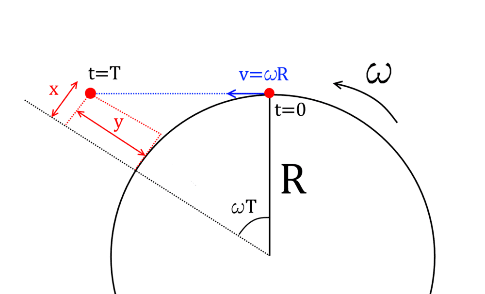

Let's suppose there's some platform that is rotating with angular speed omega and has a radius R. At t=0 we release some object from the border, which has an initial speed perpendicular to the radius direction with magnitude [tex]\omega R[/tex] and we want to know its position at t=T with respect to the initial point in the rotating frame, shown below with the coordinates {x,y}. We know the object will move along a tangent trajectory, shown with blue dot line. The length of the blue dot line is [tex]\omega R T[/tex] which is the same length of the arc covered in time T.
https://www.physicsforums.com/attachments/266688
Since this is just a geometry problem, after some calculations I reach the following results:
[tex]x=R(\sin(\omega T)-\omega T \cos(\omega T))[/tex]
[tex]y=R(\cos(\omega T)+\omega T \sin(\omega T))-R[/tex]
And it looks fine. I can also differentiate two times with respect to T to get the accelerations:
[tex]a_x=R\omega^2(\sin(\omega T)+\omega T \cos(\omega T))[/tex]
[tex]a_y=R\omega^2(\cos(\omega T)-\omega T \sin(\omega T))[/tex]
Ok, I'm quite convinced those expressions are right.

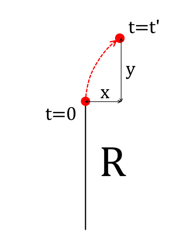

But now I imagine the problem from the rotating frame point of view. The trajectory of the released object would look more or less like the red dot arrow I think, as shown in the image below:
https://www.physicsforums.com/attachments/266685
Since no real force is acting on the object, in this case I have to explain the movement of the object in terms of two fictitious forces: the centrifugal force, responsible of movement along y direction, and the Coriolis force responsible of the movement along x direction, I think. For a 2D problem, we can write the acceleration as:
[tex]\vec a=\vec a_r+\vec a_\theta= (\ddot r-\dot\theta^2r)\hat r + (r \ddot \theta + 2 \dot \theta \dot r) \hat \theta[/tex]
But here I don't understand how to introduce the angular speed of the rotating frame, so I've not succeeded to formulate the problem in terms of the fictitious forces to reach the previous result. If any of you knows, I would be very thankful if you can show me.

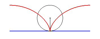

I am unable to help you with the math of this problem, but it seems to me that the solution may be equivalent to the equation of motion for the cycloid trajectory of a point of a wheel (the point of reference in the edge of the platform in your problem) that is rolling over a horizontal surface (the rectilinear trajectory of the released object in your problem, which rotates with ω velocity respect to that point of reference).
Please, see:
https://en.wikipedia.org/wiki/Cycloid
https://mathcurve.com/courbes2d.gb/cycloid/cycloid.shtml

These are the two images.
Likes Lnewqban
Ibix said:
Are ##x## and ##y## Cartesian coordinates in the inertial frame? If so, I'm not convinced that your expressions are correct. Surely the trigonometric functions should depend on the release time (call this ##T_0##) while the linear velocity term depends on the time (you seem to have used ##T##). In fact, you can tell that your expressions aren't correct because the acceleration of an inertial particle expressed in inertial coordinates should be zero, which you clearly don't have.
Are the images visible now?
I know in the inertial frame the acceleration with respect to a fixed point should be zero...
But as you can see, x and y refer to a fixed point in the rotating frame.
I hope my question is more clear now... it's a pity the images are not displayed... but I can not edit the post anymore for some reason...
Please, see:
Very nice... indeed it seems to be an equivalent scenario. I'll read a little and then compare results.
Likes Lnewqban

Very nice schematics, thank you.
Clearly, the motion as seen will not be a cycloid. Although the initial behavior is very similar the eventual behavior as seen from the rotating frame will roughly approximate an archimedean spiral -- each successivel loop a fixed distance from the last.

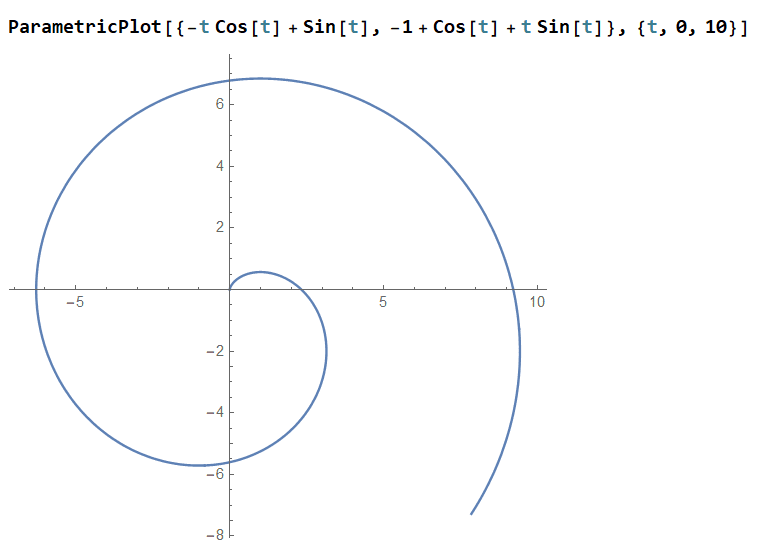

Actually I plotted the result I reached for R=1 and omega=1 and it looks like an spiral as you say:
If I shift to a coordinate system anchored to the center of rotation I think the only difference is adding +R (in this case +1) in the "y" direction, isn't it?? I think formulating the centrifugal potential is not enough, since the particle is not only moving radially but also in theta direction, so a Coriolis acceleration should be considered too.

Seen from the rotating frame, it's of course a spiral, as said in several previous posts already.

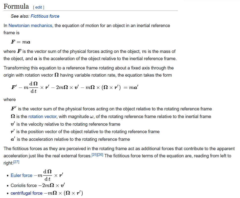

See the wiki on Coriolis Force for the formula for the fictional forces a body appears to experience when the motion is considered in a notating frame.
Why fictitious?
Because they are not real forces. If you want F=ma to apply in a rotating frame you have to invent other forces, dependent on the rotational speed, to get the body to move as it does move.
Why fictitious?
Yes, I checked those formulas and wrote the x and y components of the acceleration in the rotating frame, reaching the following system of entangled equations for x and y:
[tex]\ddot x = 2\omega\dot y + x\omega^2[/tex]
[tex]\ddot y = -2\omega\dot x + y\omega^2[/tex]
Honestly I don't remember exactly how to solve this manually but when I solved it with Wolfram Mathematica setting the boundary conditions for t=0 as x[0]=0, y[0]=R, vx[0]=0 and vy[0]=0, I got the same expressions in the original post. So I think it's verified now. This is what I wanted, to reach the same result by using the fictitious forces in the rotating frame. It's quite curious that a more or less complicated system of differential equations can be solved as a much more simple geometric problem if one if able to do the correct transformation of the coordinates. (In this case going back to the inertial frame)
