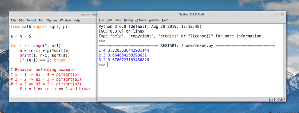

Good morning, Dear Friend Gionata, even if it is evening.
Let me please to share this example, maybe it could be of help for You.
