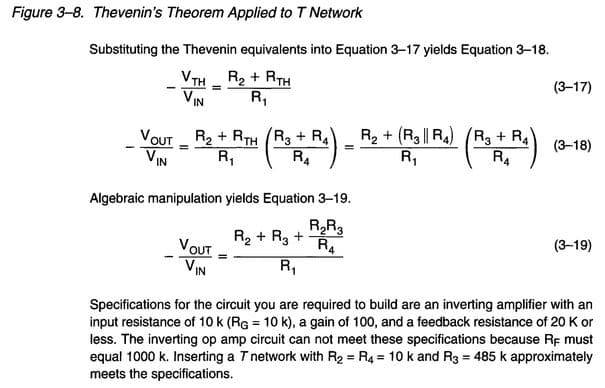

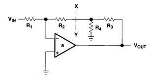

Reduce the feedback resistance for the following T-Network
Basic circuit analysis (Thevenin maybe?)

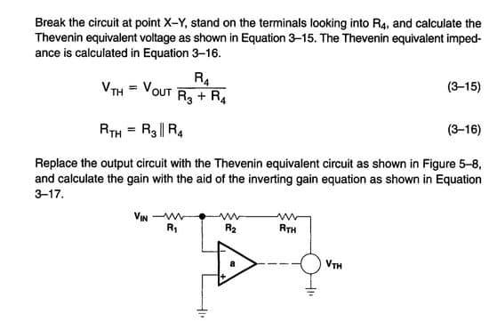

My first though was to use Thevenin, and actually I've found some book used that method:
The Thevenin approach looks fine. Did you have some question about it?
Thank you for your quick respond. My question is whether this approach OK or not. And if the feedback resistance can be reduced more.
The approach is good, and I doubt that the resistance can be simplified further (other than rearranging it algebraically) without plugging in actual values to reduce it to a number.
Typically it is a good idea to get it in the form of
G=NUM/DEN.
in other words, simplify to get rid of R2*R3/R4 in the Numerator
As an alternative, you can apply the star-triangle transformation.
After applying this transformation there will be two resistors which do not influence the closed-loop gain (and can be neglected).
