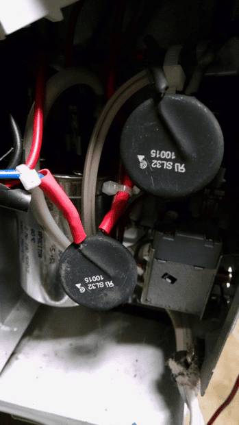

I've used these types of current limiters on line voltage devices like air conditioners with compressors that trip battery powered inverters because of high start currents.
https://www.ametherm.com/
https://www.ametherm.com/datasheetspdf/SL3210015.pdf
Likes Delta Prime

BTW, I have used NTC resistance devices (as shown in the picture by @nsaspook ) on a specialized load device to limit its inrush (because it used relays to connect to the AC Mains and the relays could not withstand the inrush current repeatedly without fusing their contacts). It is very important to consider the power dissipated by the NTC devices during steady-state operation, since there is still a non-zero resistance through the device, and the dissipated power depends on the steady-state current. We had trouble getting UL approval for one such device, due to the internal temperature rise from the NTC protection devices -- that was a royal pain to fix.
Likes nsaspook and DaveE
