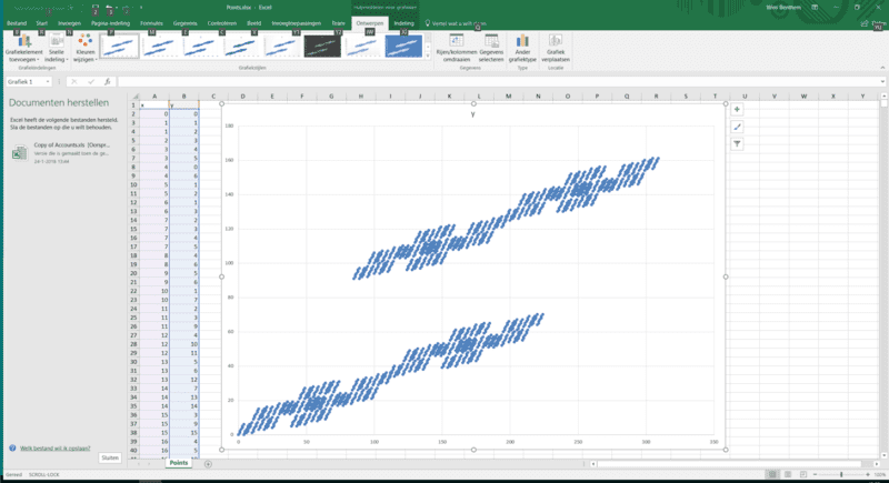

This doesn't seem to be a very good project for MsAccess. I suppose you could use a points table with attributes (x, y) as a unique key, and start with only (0,0) in it and then run 50 insert queries where you insert (x+v.x, y+v.y).
The msaccess method might actually be feasible. After using twelve random vectors I get 1775 points in the table.
Export the table to Excel and make an xy graph.
A primitive fractal. Of course if you use many more vectors it will start to look more like a blob.
