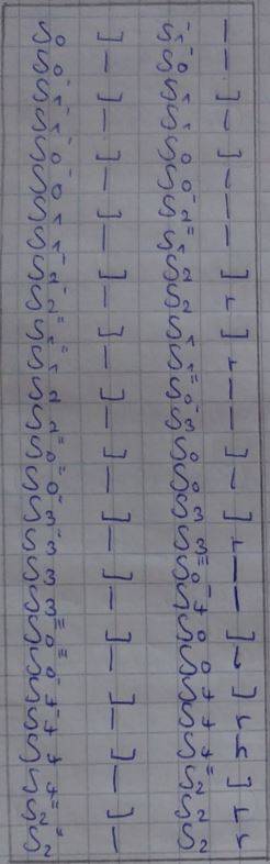

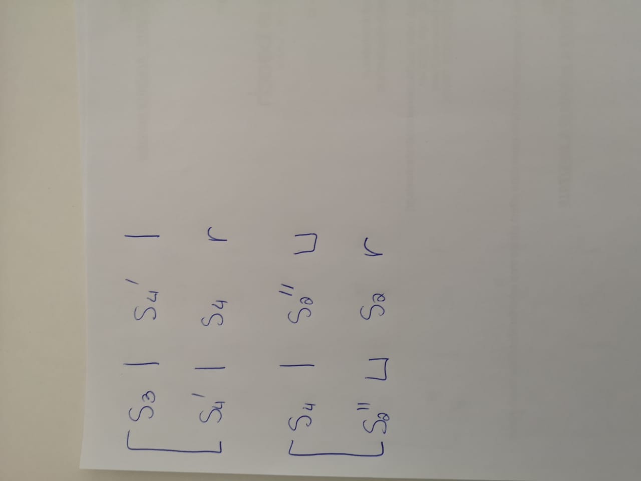

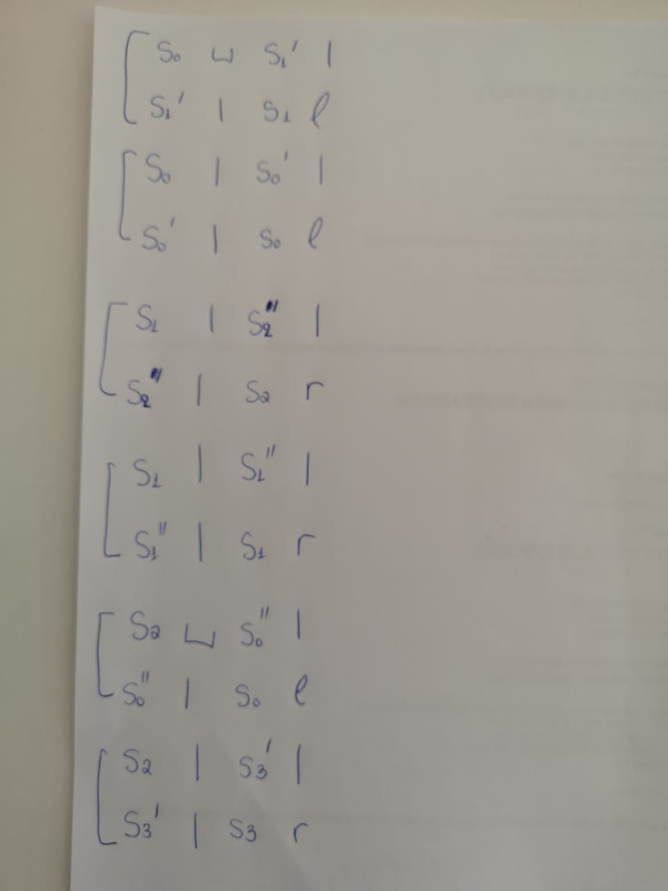

So if we write each line of the given table as two lines we get them the following:
Is that correct? If yes, could you give me a hint how we get an equivalent tm with at most 8 states? (Wondering)
Has the ordinary TM have to be deterministic? Because the given is not because of $s_4$ since we know only what we do if we read the symbol $\mid$ but not what we do when we read the blank. Or is that wrong? (Wondering)
Wiki says:
In some models, if there is no entry in the table for the current combination of symbol and state, then the machine will halt; other models require all entries to be filled.
So I think the given Modified Turing Machine is intended to halt if it reads a blank in state $s_4$.
For the 4-tuple Ordinary Turing Machine it depends on which definition we're using.
We can either define a set of final states, or leave reachable state transition(s) undefined, or both. (Thinking)
Let's consider the first line of the given table: $(s_0,\sqcup,s_1,|,\ell)$
This can be done in two steps as follows:
$(s_0,\sqcup,s_1',|)$
$(s_1',\mid,s_1,\ell)$
So that the resulting TM is deterministic, what has to be done? Do we make it as $(s_1',\sqcup,s_1',\sqcup)$ which doesn't change anything? (Wondering)
It is already deterministic isn't it?
We can only reach state $s_1'$ after writing a | without moving the tape.
So if we read in state $s_1'$ we can only read a |.
It is not possible to read a blank, so we do not need a state transition for it either. (Thinking)

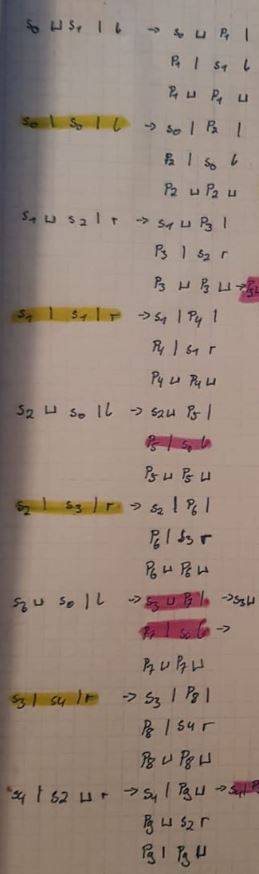

I thought so because I saw the following solution (I don't know for sure if that is correct):

Ok! But why do we have at #16 at the (proposed) solution at each step the third line? (Wondering)
Perhaps the context of the problem defines its Ordinary Turing Machine such that every state - that is not a final state - must have a state transition for all inputs... (Thinking)
After all, we already now that what the problem considers an 'ordinary Turing Machine' is not the definition that wiki gives.
Or perhaps those steps are indeed redundant... (Thinking)

Is the third line at each step of the proposed solution at #16 justified by the above? (Wondering)
No. It is not.
The above specifies the single transition I suggested and leaves out that third line at each step. (Nerd)
No. It is not.
At the given table of the modified TM of #1 do we not have $\delta (s_4 ,\sqcup )=\emptyset$ ?
So according to the definition do we not get the following ordinary TM ?
$(s_0,\sqcup,s_1,|,\ell)$ gets $(s_0,\sqcup,s_1',|), (s_1',\mid,s_1,\ell)$
$(s_0,\mid,s_0,|,\ell)$ gets $(s_0,\mid,s_0',|), (s_0',\mid,s_0,\ell)$
$(s_1,\sqcup,s_2,|,r)$ gets $(s_1,\sqcup,s_2',|), (s_2',\mid,s_2,r)$
$(s_1,\mid,s_1,|,r)$ gets $(s_1,\mid,s_1'',|), (s_1'',\mid,s_1,r)$
$(s_2,\sqcup,s_0,|,\ell)$ gets $(s_2,\sqcup,s_0'',|), (s_0'',\mid,s_0,\ell)$
$(s_2,\mid,s_3,|,r)$ gets $(s_2,\mid,s_3',|), (s_3',\mid,s_3,r)$
$(s_3,\sqcup,s_0,|,\ell)$ gets $(s_3,\sqcup,s_0''',|), (s_0''',\mid,s_0,\ell)$
$(s_3,\mid,s_4,|,r)$ gets $(s_3,\mid,s_4',|), (s_4',\mid,s_4,r)$
$(s_4,\mid,s_2,\sqcup,r)$ gets $(s_4,\mid,s_2'',\sqcup), (s_2'',\sqcup,s_2,r)$ Now we have that \begin{align*}\delta (s_1', \sqcup)&=\delta (s_0', \sqcup)=\delta (s_2', \sqcup)=\delta (s_1'', \sqcup)=\delta (s_0'', \sqcup)\\ & =\delta (s_3', \sqcup)=\delta (s_0''', \sqcup)=\delta (s_4', \sqcup)=\delta (s_4, \sqcup)\\ & =\delta (s_2'', \mid)=\emptyset \end{align*} or not? So according to the last line of the definition we have to add for each of these ones an additional transition, which are the following:
\begin{align*}&(s_1', \sqcup, s_1',h), \ (s_0', \sqcup, s_0', h), \ (s_2', \sqcup, s_2', h), \ (s_1'', \sqcup, s_1'', h), \ (s_0'', \sqcup, s_0'', h)\\ & (s_3', \sqcup, s_3', h), \ (s_0''', \sqcup, s_0''', h), \ (s_4', \sqcup, s_4', h), \ (s_4, \sqcup, s_4, h), \ (s_2'', \mid, s_2'', h) \end{align*}
Or have I understood that wrong? (Wondering)
If that is correct, how could we find an equivalent TM with at most $8$ states? For that do we maybe ignore states in the form $(s_0,\mid,s_0',|)$ wheere we read the same as we write? (Wondering)
