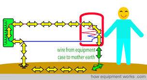

2. Can you elaborate a little on what you mean by earthing is done from the protection point of view?
Consider a device with metal body. If live wire comes in contact with the metal body(after insulation failure) and a person touches the device, he'll get an electric shock if the device is not earthed. If the device is earthed, it's metal body will be connected to the ground(actual "earth" ground). Hence, it will bypass the person's body and fault current will directly flow into ground through the ground wire, without harming the person or other components of the device.
