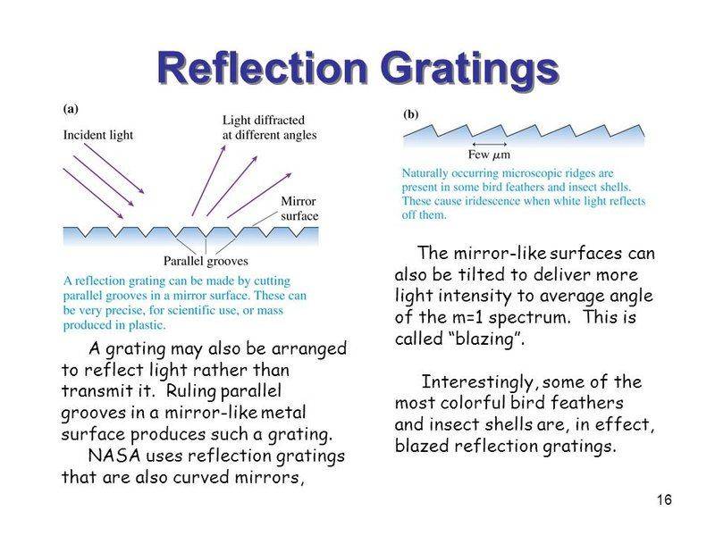

Sheldon11 said:
How a reflection grating works as diffraction source?
by changing the angle of the incident beam of light

Can a steel ruler be used as a reflection grating ? if so, why?
Why do I get the feeling this is a homework question?
