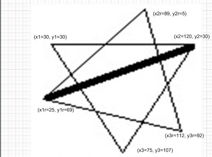

How to rotate a triangle over a line? I have provided a attachment for it?
Y= mx +c
I don't know the eq for reflection
My plan is find the eq of line. I have got points for the end points of the line but i don't know how to reflect the triangle over the line which is not straight. I searched the internet but i can't find any eq. Eq are provided for reflecting over x-axis, y-axis , over the line x=2 & over the line x=y but no equations are shown for rotating object over an oblique line. One site gave the method to find the eq of line which was used to rotate the triangle but it don't give any example for reverse case. Its link was:
http://www.rcboe.org/cms/lib010/GA01903614/Centricity/Domain/1030/Reflections.pdf
I have attached the figure. I want to rotate the triangle over the dark line.
Some body please guide me.

First thing to do is find the right question to ask.
So far, title, link and missing equation are about reflection. The figure title says reflection too. But I see a 6 point star and a fat line. The fat line connects two tips but has little to do with any reflection nor with any rotation.
So: make up your mind :smile:. What is it really that you want to do ?

If a point is reflected across a line, a line segment joining the new (reflected) point and the old point will be perpendicular to the line of reflection, and both points will be the same distance from the line of reflection, and on either side of it.
If a figure is rotated, the pole or point about which rotation occurs has to be stated. For example, if the line segment between (1, 1) and (3, 3) is rotated 45° clockwise around the origin, the rotated segment will lie along the x-axis between ##(\sqrt 2, 0)## and ##(3\sqrt 2, 0)##. Both line segments have the same length, ##2\sqrt 2##, but their orientation is different.

and you want to extend that to the line y = mx + c.
One way to do that is to reduce the latter to one of the known ones using a series of coordinate transformations: shift down by c, rotate around the origin until the mirror line is vertical (i.e. over ##\pi/2 - \alpha\ \ ## where ##\ \ \tan\alpha = m## ), then reflect wrt the y-axis (i.e. change x to -x), rotate back to mx ( over ##\ \alpha - \pi/2## ) and shift up by c.

Hi,
Thanks for updating my post. I have made a figure and specified the coordinates of the original and the rotated triangle. This would help to understand my problem.
I want to do reflection of the superimposed triangles over the line formed by the points (x1r, y1r) and (x2, y2).
I don't know the actual equation to find out the coordinates of (x1reflected, y1reflected) , (x2r_reflected, y2r_reflected), (x3reflected, y3reflected) and (x3r_reflected, y3r_reflected). Somebody please guide me.

Do you know how to find the point on a line that is nearest a given point? From there it is easy.

The distance is not helpful. Once you have (x0, y0) and the point on the line that is nearest to it, finding the mirror image in the line is trivial.

Hi,
This prob has been solved using composite transformation. https://forum.allaboutcircuits.com/threads/reflection-of-a-point-over-a-line.134557/
Thanks for guidance.

For what it is worth, if you have a point X=(x,y) and the nearest point to it on the line is X'=(x',y'), the mirror image, X", of the point can be found by considering the vector XX'. This must equal the vector X'X", so
X"-X'=X'-X
X'=2X'-X.
