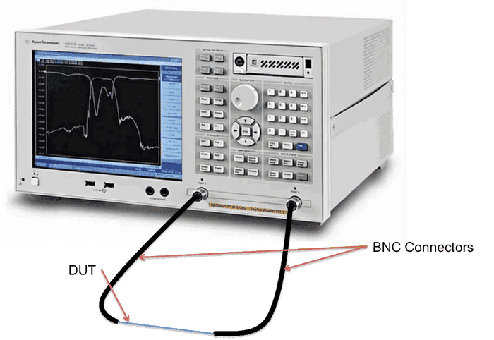

What I'm thinking is something like this:
(The BNC connectors are 50Ohm impedance RF cables.) Is something like this going to produce any good results? I understand there will be a large impedance mismatch between the BNC cables and the wire, so is there a way to overcome this?

In principle, a TDR can show you any changes on a line. The problem with looking at the return from a line that does not have a well defined 'return path', such as coax or strip line is that there will be severe dispersion of the return pulse. This is because of the multiplicity of path lengths for the returned signal.
If you want to test the unscreened line in your diagram, you might find it best to run it over a ground plane, at a constant height, to reduce the line impedance to something as low as possible ( something arbitrary but constant; perhaps 200Ω?) and then terminate it was well as you can. The trace would then show a step up from 50Ω at the transition point and a (hopefully) horizontal trace at the new impedance value, with blips on it.
However, one reason for using a TDR is when you cannot actually see the conductor you are investigating. I would think that a visual inspection would be far more fruitful than trying to use a TDR to identify lengths with surface corrosion and consequent series resistance.
BTW, For reflectometry, is it not normal to have a termination on the end of the line, rather thanking into another port on the reflectometer? The setup you show would involve an embarrassing reflection where the wire goes back inside the coax. Also, BNC connectors may not be very suitable for situations where time domain reflectometry is used. What frequency is this equipment doing to be operating at?

I suggested a ground plane, actually - not a second wire. It would give half the impedance of a pair. Imagine the way a coax is connected to a pcb and replace the microstrip with your wire under test.
My comment about the multiplicity of paths is because the wave is no longer constrained inside the coax. Currents will flow along the outside of the coax. There will be a massive discontinuity and equal and opposite currents will flow on the continuing centre conductor and the outside of the screen and waves will propagate in a very unpredictable way. If you want to launch a wave along just the centre conductor, you need to use a horn transition (see Goubau Line links).
It's hard enough to make a good narrow band transition from one line configuration to another. Doing it for a step waveform is more problematical.
If you actually have access to the equipment in the picture then I suggest you try an experiment and see what you get. I would think the trace could be very confusing.

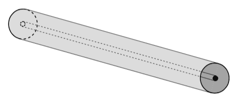

To test a single short wire, thread it into a metal tube using closed cell foam as the separator. It is then a coaxial cable. If you do not use an outer shield you will get a noisy trace due to the wire antenna picking up local RF signals, you will also be transmitting about 20 mW of broadband clicks.

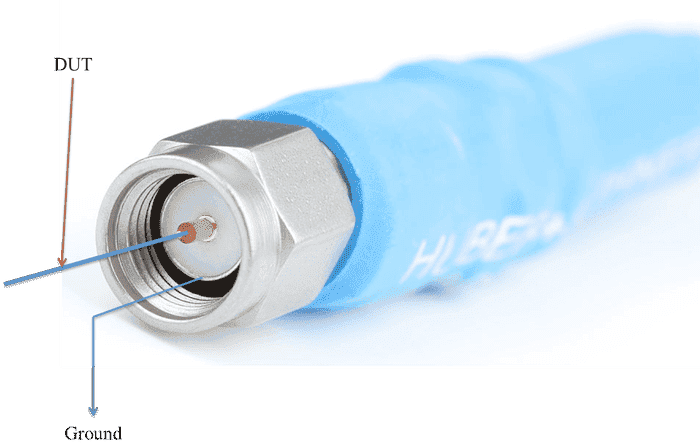

Thanks for all the input everyone. I'll try my best to respond to everyone, if possible.

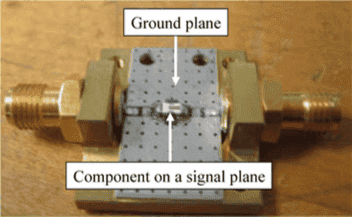

Do you mean something like this (with the other end of the DUT terminated into a SMA cable in a similar fashion):
My only experience with TDR has been with surface mount components that were arranged as:
So, I'm curious if there could be an arrangement where a single strand wire could be monitored using TDR. This wire is covered in a dielectric insulation material, as illustrated below (the center is the metallic conductor).
As a mechanical engineer, I'm a little new in the whole electromagnetic wave arena, so forgive me if what I'm asking is super basic.

It's hard enough to make a good narrow band transition from one line configuration to another. Doing it for a step waveform is more problematical. If you actually have access to the equipment in the picture then I suggest you try an experiment and see what you get. I would think the trace could be very confusing.
I do have access to a VNA. What kind of experiments would you suggest? Should I attempt to use a horn transition to launch a wave into the center conductor of a wire?
