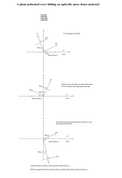

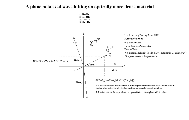

Hi!
I have a problem understanding what happens when a plane electromagnetic wave hits a surface consisting of two medias of different optical density.
My old school litterature tells me two formulas which I really don't understand where they come from.
The same teacher starts by telling me these facts:
1) E1t=E2t
2) H1t=H2t
3) D1n=D2n
4) B1n=B2n
where n stands for normal to the surface and t stands for tangential to the surface.
In my drawing I have tried to use 1 and 3 to wind up with my teacher's curious formulas like
[tex]\frac{E_{rn}}{E_{1n}}=-\frac{sin(\theta_1-\theta_2)}{sin(\theta_1+\theta_2)}...1.1[/tex]
and
[tex]\frac{E_{rt}}{E_{1t}}=\frac{tan(\theta_1-\theta_2)}{tan(\theta_1+\theta_2)}...1.2[/tex]
but I get a totally different answer like for instance for the tangential part
[tex]E_1sin(\theta_1)=E_2sin(\theta_2)+E_rsin(\theta_r)...1.3[/tex]
which may be rewritten as
[tex]\frac{E_{rt}}{E_{1t}}=\frac{E_rsin(\theta_r)}{E_1sin(\theta_1)}=\frac{E_1sin(\theta_1)-E_2sin(\theta_2)}{E_1sin(\theta_1)}...1.4[/tex]
or
[tex]\frac{E_{rt}}{E_{1t}}=\frac{E_rsin(\theta_r)}{E_1sin(\theta_1)}=1-\frac{E_2sin(\theta_2)}{E_1sin(\theta_1)}...1.5[/tex]
which isn't even close to my teacher's formula.
So what am I doing wrong?
