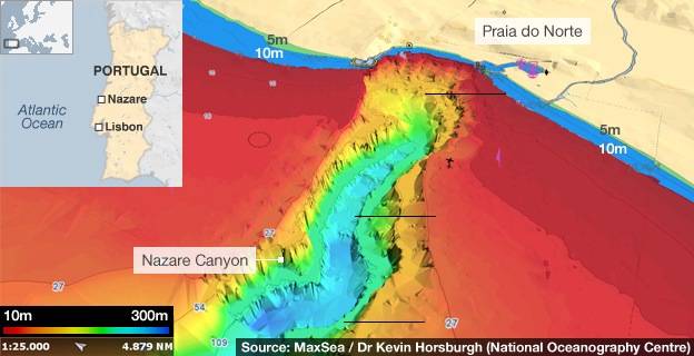

What do you think is causing the convergence in this picture ? I’ve only ever read that it’s caused by refraction there has never been described as requiring an angle only a velocity differential.
There is something seriously wrong with a lot of websites if this is not refraction
I guess I am confused by some of the "tangents" in this thread.
Based on the picture, I think the convergence around the headland happens because the shape of the headland continues under water. The incoming waves encounter the depth contours obliquely and are refracted because the surface waves slow down as they shoal.
If you encounter a (wide) depth discontinuity, then you can try to model this by matching conditions at the discontinuity, just as you would for a light ray crossing from one medium to another, which results in Snell's Law.
Alternatively, you could get diffraction if you have waves impinging obliquely on a very narrow (referring to actual extent, not abruptness of the depth transition), in which the wave crests will "bend around" the obstruction, i.e., the usual demonstration of Huygens' Principle. You don't need depth change to explain this effect, however.

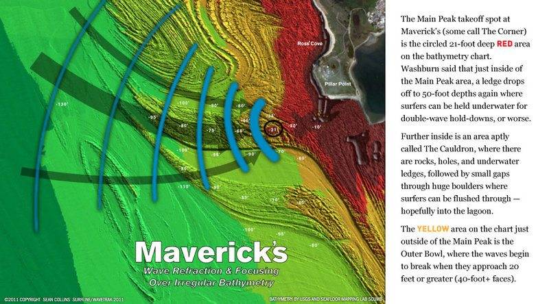

Yes this the point I feel @jbriggs444 made very well but the most common surfing examples of this happening Mavericks Nazare Jaws it’s actually abrupt depth changes across the wave ray (deep offshore channels or ridges) that cause the most significant Focussing ... where the 'intermediate' depth profile approaches the zero limit case the larger the convex focusing occurs.
The only thing that seems to be evident from real world examples is that the wave rays must stay ‘joined’ and you can see large portions of consistent deeper depth profile outside of the shallow headland that should progress at the same speed ‘dragged’ by the slower shallower sections to ensure that the wave Ray remains joined . I’m scared to suggest it but almost like a boundary layer
I believe you are referring to the abrupt depth changes oblique to the wave crests, (rays are in the direction of wave phase propagation, which is normal to the crests). That's what tends to focus the incident waves into the characteristic 'vee' shape.
If by "almost like a boundary layer" you mean that physical quantities such as a velocity and pressure in the case of the waves must match across the discontinuity, then the physics require it. Wave crests are "piles" of water, so if you suddenly "cut off" the wave crest on one side the piles will tend to slump off to that side. That's why jbriggs444 and sophiecentaur mentioned earlier in the thread that wave phase has to be continuous across the discontinuity, and that you should look at Snell's law for geometric optics or Huygen's principle for wave diffraction, etc. They can all help explain what is observed in these real world examples.
