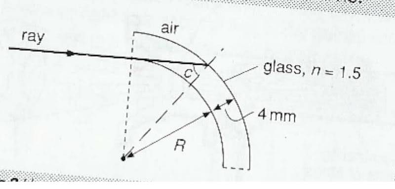

"figure 3" (below) shows an optical fibre bent in a curve. The diameter of the fibre is 4mm. If light is not to escape, calculate the smallest radius of R of the curve round which the fibre can be bent. Assume that the fibre is surrounded by air (refractive index 1) and that the refractive index of glass is 1.5"
n1
___ = SinC (critical angle)
n2
Well, I've got c, the critical angle -
__ = 0.666... sin-1(o.666) = 41.81
1.5
But, I can seem to make a triangle with enough information to get R. I've tried splitting it up, but either get not enough information to do sine or cosine rules, or a non right angle triangle. Maybe I'm just missing something?
Call the acute angle at the centre between the dashed and dotted lines A.
If the fibre makes a quadrant then the angle between the incoming ray and the dotted line is 90 therefore angle A is 90-C.
The dotted line is length R, the hypotonuse (dashed line) is R+4mm and the angle is (90-c)
So cos(90-C) = r/(r+4mm)
So just rearrange that to give me R? Ill give it a shot.
