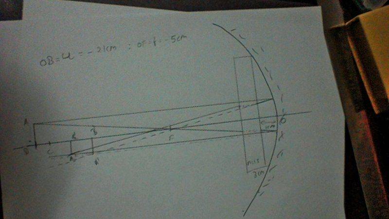

An object is placed 21 cm in front of a concave mirror of radius of curvature of 10 cm. A glass slab of thickness 3 cm and RI =1.5; is then placed close to the mirror. Find the position of the final image.
Take distance of closer side of block as 1 cm from the mirror.
##\frac{1}{f}= \frac{1}{u} + \frac{1}{v}##
u is the object dist. and v is the image dist.
##lateral~ shift~=~t\frac{\sin(i-r)}{\cos(r)}##
Ignoring the block i get ##v = -6.56 cm##
I don't know how to consider the block... i tried this..
i need the length of B'B'₂
I have the measure of a perpendicular drawn from A' to the line through A'₂ which was suppose to go through the focus..

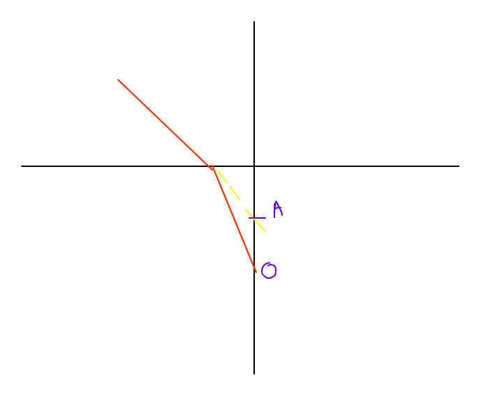

Normal shift and lateral shift are two different things . We are interested in calculating normal shift not lateral . I have no idea about the formula you have mentioned . Please check your notes on how to calculate the normal shift produced by the glass slab .Again , normal shift doesn't depend on the angle .
Have a look at the picture attached .
You need to calculate distance OA .

I thought we needed lateral shift.. ok normal shift ..then its just 5.67 cm (##\frac{d}{n}##)
but i still think its lateral shift and not normal shift, normal shift would be this..
I think the diagram you have drawn is actually for lateral shift as the emergent ray is parallel to the incident ray...
So i cannot apply the formula ##d' = \frac{d}{n}##or normal shift = ##d(1-\frac{1}{n})## where n is RI of glass wrt air

Don't you think the emergent ray would be parallel to the incident ray after two refractions due to the glass slab ?
This is the right formula . So , now what is the normal shift ?

Yes it will be, so if the emergent ray is parallel to the incident ray... there is a lateral shift, not normal shift, right?? A component of the lateral shift is the distance between the position and apparent position.

you're trying to calculate the effective object distance which would become ##(u=21 -1 = 20 cm )##
so then applying mirror formula i get v = 6.67 cm ... but due to the slab there is a second refraction causing the image to shift by 1 cm ... = 6.67+1= 7.67 cm
I'm sorry it took me so much time.. :) and for irritating you so much...
Thanks a ton!
