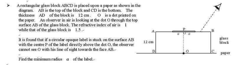

refraction -- when can you see past the label?
as shown in the figure.
n1sin1 = n2sin2
n1 and n2 represent the refractive indices of media 1 and 2 respectively
Critical angle for glass-air interface = arcsin(1/1.5) = 41.8 degree
so,a = 12tanC = 10.7cm?
I just guess...I am not sure about what the question is asking for...
Does it mean,assume the observer's position doesn't change,
he can see O before placing the circular label.And he couldn't see O after placing the circular label?

Show your attempt of solution, please. What equation is relevant? Draw the light ray from the spot towards the observer's eye. ehild

Sorry,I have just edited my question.
Your solution means that the light can not get out from the glass if that label is placed above the spot onto the surface. When a light ray strikes the surface at angle lees then the critical, the label is there. If it strikes the surface at angle greater than critical, it totally reflects. The observer can look from any direction, he can not see the spot. I think the problem means that solution. Otherwise the position of the observer should have been given.
ehild

Yes!
I agree with ehild regarding the interpretation of this problem !
