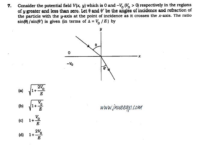

I think that ## \frac { \sin \theta } {\sin \theta ' } = \frac { n_2} { n_1} ##
I am taking the dielectric constant as 1 as the potential is 0 i.e. the medium is air..
So, ##n_1 = 1##
For the 2nd medium,
The dielectric constant ## \epsilon_r = \frac { E } { E- V_0} ##
So, ## n_2 = \sqrt{ \frac { E } { E-V_0 } } = 1+ \frac { V_0 } {2E } ##
What is wrong here?

I haven't solved it in its entirety yet, but I think the problem makes use of the Schrodinger equation. Try writing out the Schrodinger equation in two dimensions with an incident plane wave particle with ## \psi (\vec{r})=e^{i \vec{k}_o \cdot \vec{r} } ## and ## \vec{k}_o=k_{xo}\hat{i}+k_{yo} \hat{j} ##. ## \\ ## Editing: To complicate the problem, you might also get a partial reflection at the boundary, with angle of incidence =angle of reflection. (I'm not sure because I didn't solve it completely yet).
