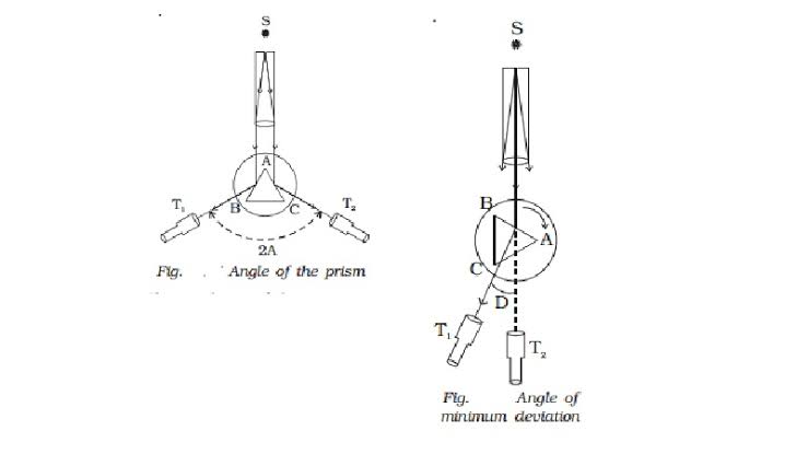

In the image attached, How is it that the angle shown is 2A? And what exactly is the position of min deviation? Why does it have to be in the given position as shown?
Thanks in advance!
Keep in mind that the angle of incidence equals angle of reflection, and you should be able to do the trig yourself,
It doesn’t. They didn’t want to give it away. You are supposed to rotate the table until the beam deviates the least. You will find it does not occur in the orientation shown.
Likes VVS2000
Well I was instructed to rotate the table until the image moves in the opposite direction of rotation. Why should this be the point where light deviates the least?

No I was'nt talking about the derivation. When you're doing it practically, why does the angle which you measure in the picture I attached is 2A? Twice the angle of prism?
I was trying to answer your second question. I believe the first one is simply trigonometry.
Oh sry. Yeah I think I got the first one. I thought you were offering a different perspective
Ok, so practically is'nt there anyway to convince that position is min deviation position?
For the first one, if you use the symmetry, which may not be necessary, the incident angle on one side is ## 90-A/2 ##, making the total angle ## 180-A## on each side, for a total of ## 360-2A ##. That leaves ##2A ## for the remaining part on the circle.
This sort of question is much better answered by looking at an elementary optics textbook (or searching Google Images - which gives you many pictorial hits). Alternatively, just draw a diagram of a light ray, reflected in a mirror (a simpler model to start with) and see where it goes when you rotate the mirror a bit. If you don't like Maths too much, this should help. OR play with an actual mirror and light from a torch / LED pointer.
You can't say "why" something like that happens without a 'derivation'. The word may look like intimidating maths and something to steer clear of but the only alternative is to do many practical measurements with different angles and then you may come to the same conclusion that a few lines of maths will give you. (Only you can never be sure that the practical results apply generally and that's why we do sums in Physics)

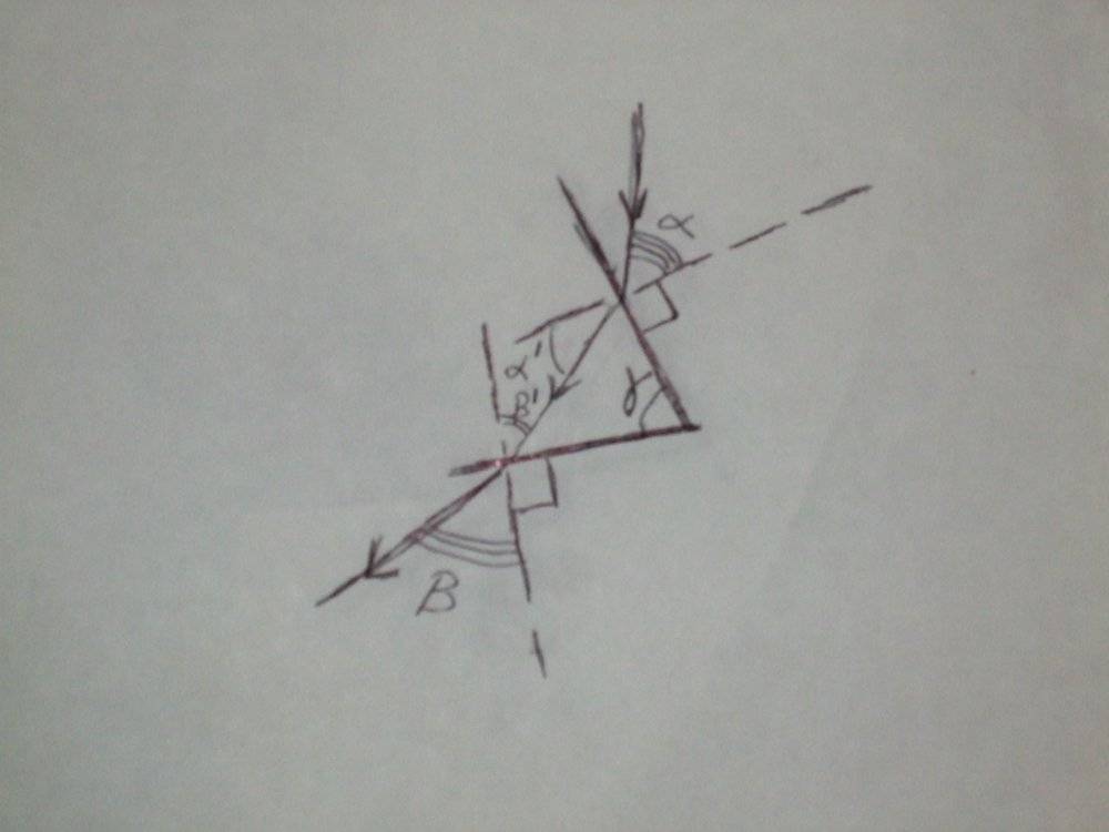

The following will apply to the figure of the above post.
Deviation angle ## \Psi=\alpha+\beta-\gamma ##.
also ## (90-\alpha')+(90-\beta')+\gamma=180 ##, so that ## \gamma=\alpha'+\beta' ##.
With Snell's law: ## \alpha'=\sin^{-1}(\sin(\alpha) /n) ##, so that ## \beta'=\gamma-\sin^{-1}(\sin(\alpha )/n) =\sin^{-1}(\sin(\beta)/n) ##.
There are just a few more steps.
We have ## \beta=\beta(\alpha) ##.
##\frac{d \Psi}{d \alpha}=0 ## gives ## 1+\frac{d \beta}{d \alpha}=0 ## at the minimum.
For ## \beta' ##, we have something of the form ## F(\beta)=\gamma-F(\alpha) ##.
This gives ##F'(\alpha) \, d \alpha=-F'(\beta) \, d \beta ##.
Since ## d\beta=-d \alpha ## at the minimum, we get ## F'(\alpha)=F'(\beta) ##,
and it should be fair to conclude that ## \alpha=\beta ## at the minimum.
I'm going to complete the derivation using one more post:
Since ## \alpha=\beta ## at the minimum, we have
## \Psi_{min}=2 \alpha-\gamma ##,
and also ## 2 \sin^{-1}((\sin{\alpha})/n)=\gamma ##,
so that ## (\sin{\alpha})/n=\sin(\gamma /2) ##,
so that ##n=\frac{\sin{\alpha}}{\sin(\gamma /2)} ##.
Finally ## n=\frac{\sin((\Psi_{min}+\gamma)/2)}{\sin(\gamma /2)} ##.
