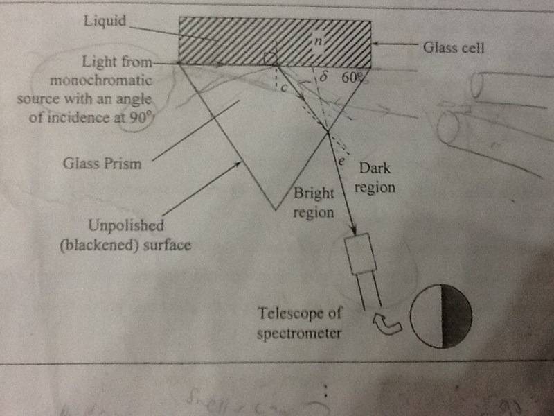

Then is this picture correct?
This is an experiment to find the region n2 refractive index
That equipment is based on the Abbé refractometer(?) which can be used to analyse tiny samples of liquids. So, yes, you could use it.
No, I am using spectroscopy and prism to detect the refraction index.
Are you using total internal reflection to find the refractive index, or what?
Sorry, it is spectrometer.
Yup it is use to find the refractive index of the glass cell.
My book says : a sharp boundary distinguishes the bright from the dark region because no rays are refracted with an angle of refraction larger than critical angle.
So ? I think the refraction will occur along the liquid glass interface. But I feel I still don't understand how the monochromatic light ray is seen.
From wiki: http://en.wikipedia.org/wiki/Abbe_refractometer
A light source is projected through the illuminating prism, the bottom surface of which is ground (i.e., roughened like a ground-glass joint), so each point on this surface can be thought of as generating light rays traveling in all directions. A detector placed on the back side of the refracting prism would show a light and a dark region.
Is your light source illuminating the entire face of the prism, or is it a single thin beam? I'd expect it to be the former, as I don't see how a thin beam at a 90 degree angle will be refracted or reflected anywhere.
Looking at the diagram again, it would appear that it is not using 'reflection' but just the limiting case of refraction as the critical angle. (Reflection must obey the laws of reflection and that ray is not reflecting) The incident ray must be traveling along the 'inside' of the liquid and just grazing the inside surface, to be refracted to just under the critical angle and into the prism. If you look at Abbe refractometers, the setup is pretty much the same, looking at the extinction angle. Of course you need a monochromatic light source or the critical angle is not so easy to find (refractive index is wavelength sensitive).
