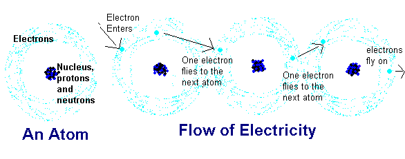

Conductors
Certain elements conduct electricity well because they give up electrons easily. We call these elements conductors. Now, copper for instance is a conductor because it has one free electron in its outer shell. Notice in the image above that the 29th electron is all alone in the fourth outer shell, this allows it to break off from the atom relatively easily.
Electrical Current (DC)
Electrical current is what we call a flow of electric charge. When an electron breaks free of its atom, that can start a chain reaction and cause other electrons to also jump from atom to atom.
The electrons themselves move relatively slowly. And the reason your lights turn on nearly instantly is because the chain reaction, the "wave" or "energy" moves very fast. This is analogous to pushing water in a large pipe. If you apply pressure to one end, water at the other end will move instantly, the water at your end of the pipe didn't have to move far at all for the water at the other end to move.

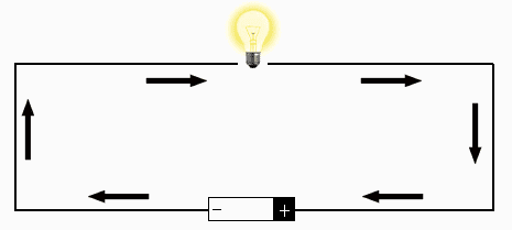

Electrical Circuit (DC)
An electrical circuit is a closed loop made of a conductive element. Electrons flow from one end of the circuit to the other and may optionally pass through a "load" which consumes the power.
In this image, the electrons flow from the anode(negative terminal) to the cathode(positive terminal). The electrons flow in this circuit because the anode contains anions which are attracted to cations in the cathode.

This makes perfect sense, but what I don't understand is how a closed circuit is formed.
The electricity from the power plant is traveling to my house, if the electrons do not travel back, how is a closed circuit formed?

Electrons in conductors are not 'knocked free' of their atoms. When metal atoms bond together, their outermost electrons are shared throughout the entire structure (structure meaning a wire, metal bar, etc). An electron that originally belonged to an atom in one corner travels allllllll over the structure relatively freely. So when you have a great many atoms bonded together, as you do in a wire, there is a 'sea of electrons' moving about that easily respond to electric fields.
Consider a broken wire that causes an open circuit. When a voltage is initially applied to the circuit, electrons throughout the metal try to flow. But the open in the circuit prevents electrons on one side of the circuit from reaching the other side. This causes a pileup of electrons on the negative side, and a reduction in electrons on the positive side, until the charge separation provides enough counter-emf to prevent more current flow (current isn't flowing across the gap, it's just that the electrons that already exist in the metal on both sides are flowing). To close the circuit you need to provide a path for these electrons to get from one side of the open to the other.

I'm not sure if you're saying that a circuit is formed between my house and the power station.
It would make a lot more sense if my house was the "load" and if the electrons traveled back in the circuit towards the power station.
Yes, a closed circuit is formed between your house and the power station.
That's a good way to think about it. The simplest way of setting up a DC circuit is to just use two conductors like we do in AC power. One wire would provide the current to your house, the other conductor would provide the return path to the power station.

Ah, okay. Thank you very much for that explanation, I was searching for an answer online but no one seemed to mention this part. :)
