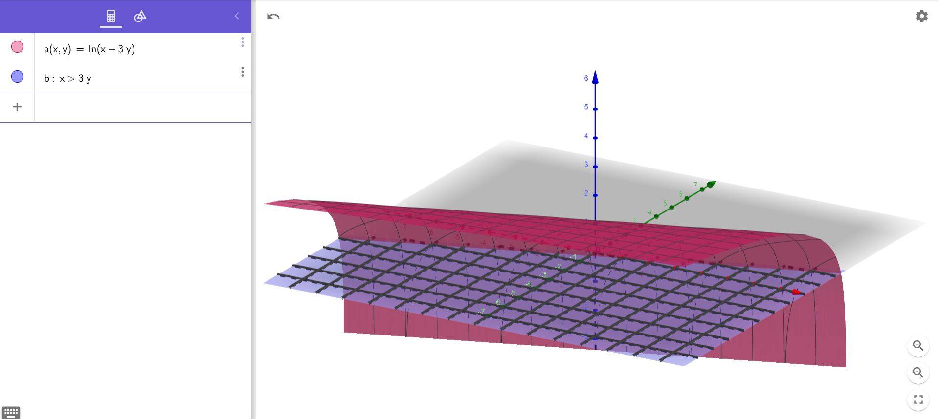

Ahh ok! Let's consider the first function $f(x,y)=\ln (x-3y)$.
Klaas van Aarsen said:
Identify domain.
It must hold $x-3y>0 \Rightarrow x>3y$. Therefore the domain is $\{(x,y)\in \mathbb{R}^2\mid x>3y\}$.

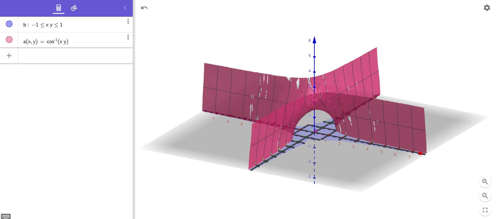

Let's consider the function $f(x,y)=\cos^{-1} (xy)$. The range of $\cos$ is $[-1,1]$ and so the domain of $\cos^{-1}$ is $[-1,1]$. Therefore the domain of $\cos^{-1} (xy)$ is $\{(x,y)\in\mathbb R^2\mid xy\in[-1,1]\}$.
Since the function $\cos^{-1}$ and the map $(x,y)\mapsto xy$ are continuous, the function $f(x,y)$ is also continuous. Therefore the region where the function is continuous is $\{(x,y)\in\mathbb R^2\mid xy\in[-1,1]\}$. (Wondering) Is that is correct, what do we have to draw in Geogebra? (Wondering)
I did the following:
View attachment 9605View attachment 9606 Is this what we have to draw? Or is it meant to darw something/somehow else? (Wondering)

That is correct. So these functions do not have discontinuities in their domain, and so there is nothing special to draw or to see for discontinuities.
Is this what we have to draw? Or is it meant to draw something/somehow else?
Seems fine to me.
The function has been drawn where it is continuous. Geogebra actually already does that for us.
Additionally you have drawn the domain where the function is continuous, which highlights that. (Nod)
