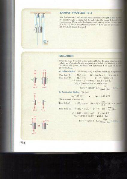

Hi!
I am new to this forum and i have problem understanding sample problem 13.5 from Vector Mechanics for Engineers 10th edition Statics and dynamics. (Beer)
In particular I don't understant in part b how he comes to the assumption aC=-1/2aD
If anyone can help
thanks
Uniform motion: ∑Fy=0
Accelerated Motion: ∑Fy=ma
[/B]
If D raises by one unit of distance, by how many units must C lower? (Take a piece of string and play with it.)
