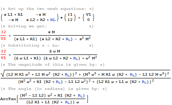

There's no need to perform any Laplace transforms to perform steady state AC circuit analysis.
See this page just beyond half way down, under the section heading "Generalized s-plane impedance" at this page: https://en.wikipedia.org/wiki/Electrical_impedance. The variable s can be taken to be simply jω for AC circuit analysis.
Then read this page: https://en.wikipedia.org/wiki/Mesh_analysis for a short overview of the technique of phasor mesh analysis.

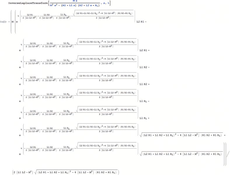

The two mesh equations are:
1.) (s*L1+R1)*I1 + (-s*M)*I2 = V1
2.) (-s*M)*I1 + (s*L2+R2+RL)*I2 = 0
The minus sign in the term "-s*M" is there because of the dotted ends of the transformer windings. If one of the dots were on the other end of the winding, the sign would be changed.
In post #8, I showed the equations in matrix form, which allows the use of a matrix solver to obtain the solution. But any technique for solving a pair of simultaneous linear equations can be used.
The Electrician, I now understand what you're trying to say and I tried so solve them manually. Luckily, I got the same answer for the magnitude and angle.
If we translate this back in the t-domain, will i(t) = L^(-1){V1(s)}*(magnitude derived)*sin(wt + (angle derived)) or i(t) = V1max*magnitude derived* sin(wt + (angle derived)) or should the phase angle be negative? Thanks.

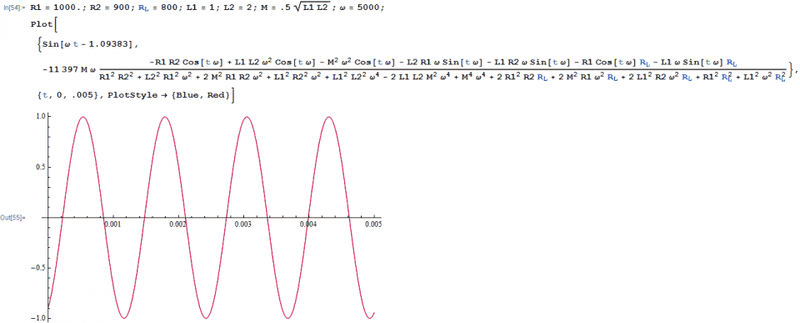

The phase of the current with respect to the applied voltage is delayed, as you would expect in an inductor, but the current in the secondary of your transformer will experience a possible additional 180° phase shift depending on where the windings are dotted: https://en.wikipedia.org/wiki/Polarity_(mutual_inductance)
How about if it is dotted the same way as you did in formulating the initial equations?
And what will the equation in the time domain will look?
Substitute some values for L1, L2, M, R1, R2, RL and ω into the expression I obtained for I2/V1:
and find the angle of the result. If the dot on one winding of the transformer is reversed, then substitute M = -M and re-evaluate the expression.

I got this answer. Is this acceptable?
Sir, also noticed that the answer is not in Amperes.

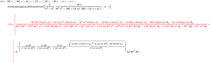

Oops. I forgot the convolution theorem.
This is not the steady state result. You will note that you have a decaying exponential factor. What you have is the result of suddenly applying a sine wave at t=0. Get rid of the exponential factor and the remaining part should be the steady state result.
But you already have the steady state result in phasor format. Why have you bothered to invoke Laplace transforms?
So the expression outside the brackets is the answer?
I applied LT since I need it to be in the time domain. Is there something wrong in doing it?
You're making me do a lot of work here. Let me explain why using phasor analysis saves a lot of work, and is the right way to do things when you want a steady state result. I'm going to use Mathematica to do a lot of the work involved here. You may have to do it by hand, or with some other method.

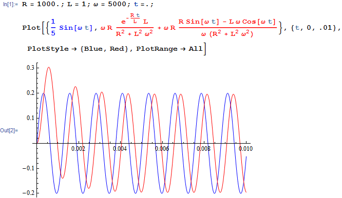

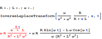

Let's use Laplace transforms to get an expression for the time domain output with a simple sine wave voltage of angular frequency ω applied as Vin.
First get an expression for the transform of a simple sine wave:
Now let's get the inverse Laplace transform of our LR circuit output with a sine wave input. A very important point here is that using this method assumes that Vin is zero until time t=0; at t=0, the sine wave is suddenly applied. In the Laplace domain we multiply the transform of the input sine wave times the expression for the output of the circuit and derive the Inverse Laplace transform to get the time domain voltage at Vout:
This consists of a transient part (in red), a decaying exponential, and a steady state part (in black), which is the voltage waveform after the exponential decays to zero.

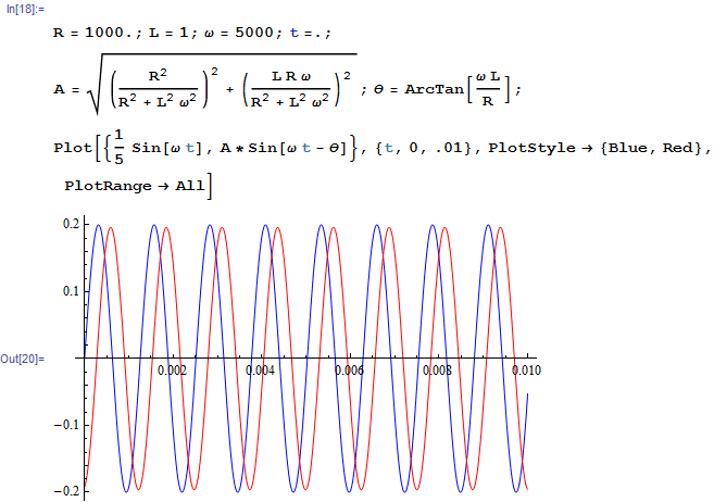

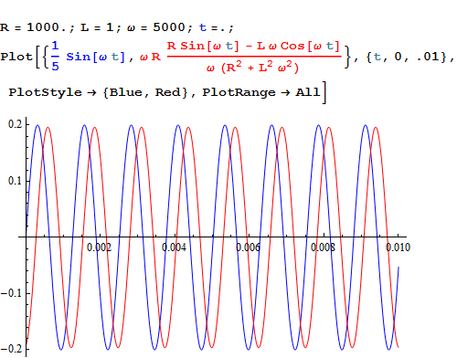

Let's plot this waveform. I'll arbitrarily pick some values for R, L and ω, and plot the output waveform (in red) starting at t=0 for several cycles of the waveform. The plot also shows the waveform of Vin (in blue) scaled by 1/5 to make it fit the plot nicely:
You can see the effect of the initial transient (the decaying exponential) at the beginning. Now let's eliminate the exponential part of the time domain expression and plot it again:
Now we have only the steady state part of the output waveform. This shows that the output is just a sine wave phase shifted with respect to the input.

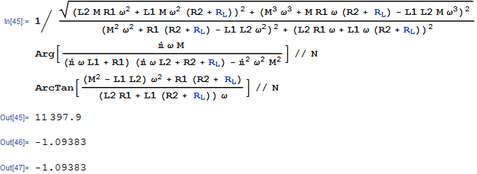

Now let's use the phasor method to get the output voltage waveform of the circuit.
The output voltage is given by Vout = [tex] Vin \frac {R}{R+sL} [/tex]
To get a time waveform we substitute s = jω. Mathematica uses a special symbol for the imaginary unit j; it should be obvious in what follows.
The phasor result is a sine wave if the input is a sine wave, which is the basic assumption of phasor analysis. The magnitude of the output sine wave is given by the magnitude of our (complex arithmetic) expression for the output fraction: [tex] \frac {R}{R+j ω L} [/tex]

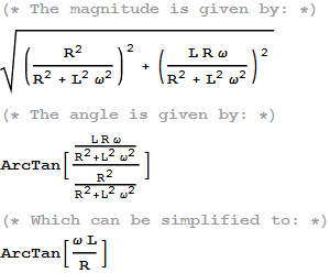

The magnitude is given by the square root of the sum of the real part squared and the imaginary part squared, and the angle is the Arctan of the imaginary part divided by the real part. So we would need to separate the real and imaginary parts. Mathematica has a function to do this, and it's relatively simple for this simple circuit. For your transformer it will be much more complicated. Herewith the separation, with the imaginary part in red:
Now we calculate the magnitude and angle of our output sine wave:
We can plot the scaled input sine wave, and the output sine wave using those values:
Here for comparison purposes is the plot of the steady state time waveform from the previous post:
It's identical. Notice how that even for this very simple circuit, the time domain expression derived with a Laplace transform was moderately complicated.
The expression for your transformer is going to be immensely complicated if you derive it via Laplace transform. Using the magnitude and angle expression derived from the phasor analysis I gave in post #8 will be much easier and less complicated looking.
The result you got in post #1 seems fairly simple, but you have a variable, (script) R, involving flux in the core and flux linkages between primary and secondary. This hides a lot of complication; you don't need to involve flux anyway. Using mutual inductance (M) is the way to go.
But, if you must use the Laplace transform, remember that the exponential part should be eliminated if you want the steady state result.
The result you have in post #18 doesn't look right. The exponential part and steady state part should be added together, not multiplied.
Correct me if my understanding of this is wrong.
So using this circuit, you determined the output to input ratio as R/(R + sL). Now since, this is Vo(s)/Vi(s), you wanted to obtain the function for vo(t), given that vi(t) = sin(wt). So what you basically did was you took the LT of vi(t) so that we will have an explicit function for Vi(s) then you arranged the expression for the ratio of the two s.t. Vo(s) = Vi(s) R/(R + sL)
Then you took the inverse laplace for this, which sounds like convoluting sin(wt) * L^(-1){R/(R + sL)}. The result is the sum of a decaying exp function and another nondecaying function. As t tends to infinity, obviously the decaying exp function approaches 0 and the nondecaying part is the vo(t) in steady state.
If that's the case, then my intuition tells me that my previous solution, excluding vo sinwt, needs to be convoluted with vo sinwt, right? Since in the first place, I took the ILT of the right hand side of I2(s)/V1(s) which is the expression on the paper excluding vo sin wt. And I just mistakenly multiplied it by vo sin wt since I have no prior idea on convolution theorem. But just a few hours ago, I was able to learn it.

Since I don't how you derived your previous solution, which I assume involved finding Inverse Laplace transforms, I can't answer your question.
You correctly described what I did. You need to do that with the phasor expression for I2/V1 I gave in post #8.
As you obviously know, in the time domain what you need to do is convolve the function sin[ωt] with the Inverse Laplace transform of the ratio I2/V1. But it's much easier to do in the Laplace domain where multiplication replaces convolution. So your big problem is to find the Inverse Laplace transform of the product of the transform of the input sine wave and the transform of the ratio I2/V1. In other words, you need to find this:
I wouldn't even think of trying to do this without the aid of modern mathematical software; but then I'm spoiled.
Just to give a taste of what your result is going to look like, here's what Mathematica gives for the Inverse transform of just the ratio I2/V1.
I assume you are a university student. Find out if your institution has network access to a modern mathematical software such as Mathematica, Maple, Matlab, etc. Such a software should enable you to derive inverse Laplace transforms.
