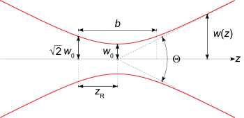

turin said:
Isn't there a relationship between beam spread (θ), wavelength (λ), and aperture (D) such that θ is approximately proportional to λ/D?
Yes.
For a Gaussian-shaped intensity profile, we have
θ = (λ/wo) / π
where
θ is the 1/e2 half-angle, or approximately the FWHM angle of spread,
wo is the 1/e2 intensity radius, or approximately the FWHM beam diameter, at the beam focus.
Note: Θ = 2θ
Figure from http://en.wikipedia.org/wiki/Gaussian_beam
You can google: gaussian laser beam -- for more details.
