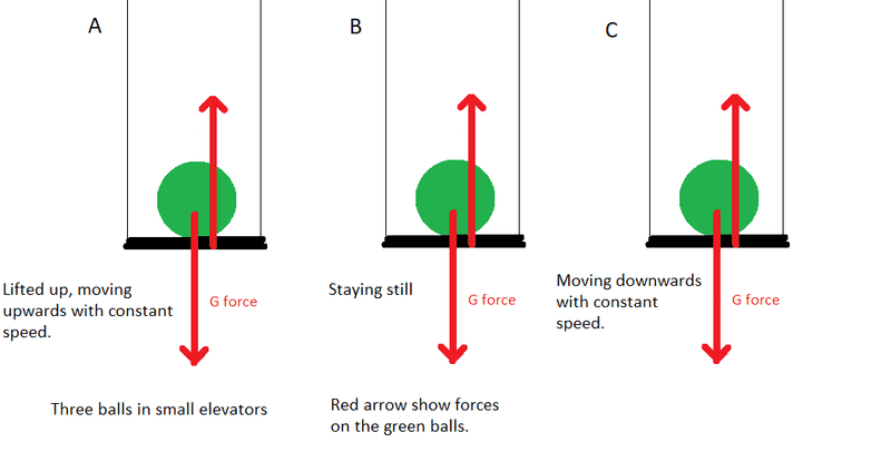

In the picture above, there are three balls in separated small elevators. Elevator A lifts the ball upwards, elevator B stays still, elevator C moves the ball downwards, all in constant speed. (And this is a model, a simplification of the reality, we assume no other forces on the balls other than gravity force downwards and normal force upwards).
Since there's no acceleration, only constant speed or staying still, sum of the forces on the ball is 0 in both A, B and C.
But lifting the ball upwards requires more energy than keeping the ball still. But how is it that sum of the forces on the ball is equal (and zero) both in A, B and C?

Yes, work done by a force is the force multiplied by the distance the force advances. In A, the normal force does work on the ball, while gravity does equally negative work. Result, no speed change.
If we assume the ball is 1KGs, then both in A, B and C the normal force to the ball is ca 9.8N?
When the forces are the same, then how is it that the ball in A moves upward (and does more work), but the ball in B is staying still?

Note that "it" in your first sentence refers to "the elevators" in your second sentence. So the only energy that you are interested in is the energy required by the elevator mechanism. So the difference between the scenarios is not the magnitude of the forces, but the direction of the displacement. In one case the displacement is in the same direction as the force from the elevator mechanism. In another case it is in the opposite direction, and in the other case there is no displacement. The net force is not relevant to the work done by the elevator mechanism. Only the elevator mechanism's force and the displacement

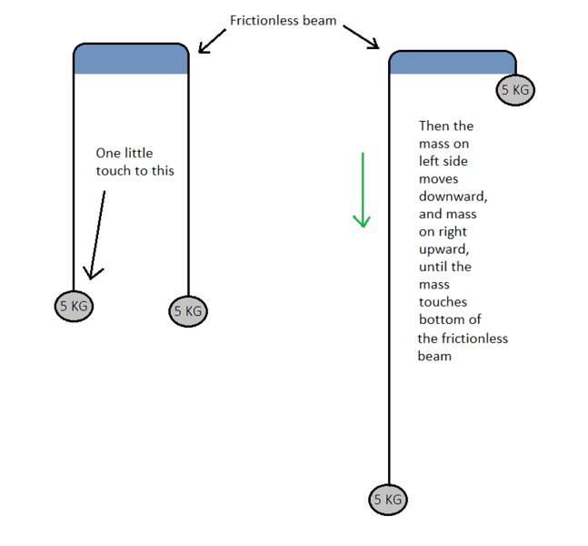

Consider e.g. two equal masses connected by a string over a frictionless beam. They may hang in equilibrium, but if you provide an initial uoward push on one then they would keep moving at that speed, the descending mass losing PE and the other gaining it.
Is this what you mean?
So it's the elevator mechanism that uses energy to lift the ball against the gravity in constant speed.
But when the elevator is still at the ground, the elevator mechanism doesn't need to use energy to keep it there. Still there are some "normal force" on the elevator so the elevator is not pulled down by the gravity. But what's the source of the energy of that "normal force"?
The point of action of that normal force does not move. So it does no work and requires no energy.
Karagoz said:
But when the elevator is still at the ground ... what's the source of the energy of that "normal force"?
The displacement is 0 so no work is done and no energy is required.
Yes.
