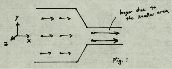

Say we know that in an irregularly shaped volume conductor (e.g. a nerve fiber, where the irregularity is due to some sort of biological obstruction), the current density [itex] \vec{J} [/itex] has the form given in Figure 1 (see attachments).

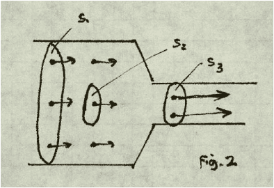

for every [itex] S [/itex], or only for [itex] S [/itex] = cross-sectional area of the conductor? The reason I ask is because, if I draw three example surfaces [itex] S_1, S_2, S_3 [/itex] (Figure 2), the surface integral of [itex] \vec{J} [/itex] over [itex] S_1 [/itex] is obviously not equal to that over [itex] S_2 [/itex].
So I guess what I am asking is: is
[tex]
\begin{equation*}
I = \iint_{S_1} \vec{J} \cdot \vec{n} dS_1 = \iint_{S_3} \vec{J} \cdot \vec{n} dS_3 \neq \iint_{S_2} \vec{J} \cdot \vec{n} dS_2
\end{equation*}
[/tex]
true, where [itex] I [/itex] is current as found from Ohm's law? And if so, does this mean that any current [itex] I [/itex] through a conductor is not simply the rate of flow of charge, but a rate of flow of charge implicitly with respect to the cross-sectional area?
[tex]
\begin{equation*}
\end{equation*}
[/tex]
Yes.
Thanks
Yes. Usually it's obvious what that surface is (current in a wire refers to the area of the wire), but if the surface isn't obvious then you need to specify it.
