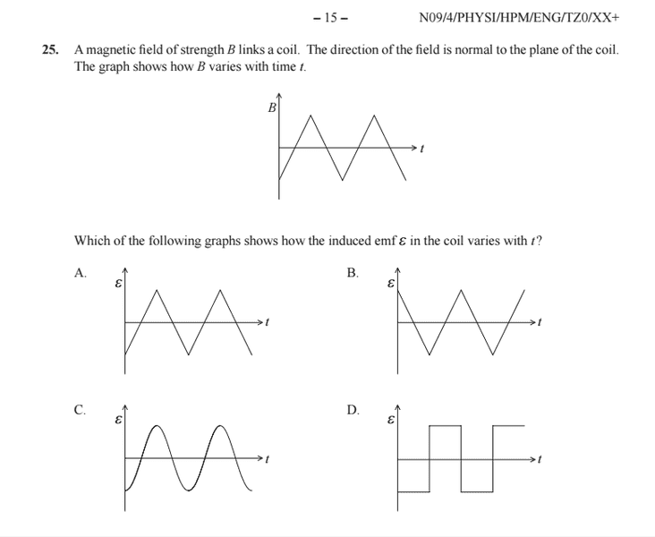

See image below.
motional emf = induced voltage = B L v
I thought the answer would be A since there's a direct relationship between EMF and magnetic field strength. The answer is D.

Welcome to PF!
You do not have any motional emf in this problem since the coil is not moving (v = 0).
Try using the most general form of Faraday's law of induction.

Doesn't Faraday's law of induction say the same thing? that emf is related to the rate change of magnetic flux? and magnetic flux = BA cos theta
so the emf is related to the magnetic field strength?
I'm not sure what you mean by the "same thing" here.
Yes, good.
Would it be more appropriate to say that emf is related to the rate of change of B?

Ahh, it makes sense now. Thank you!
