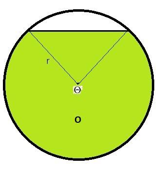

I did a calculation to determine whether a liquid with a fixed volume ##V##, would be spread over a larger surface area ##A## on the inside mantle of a cylinder, if the cylinder has a larger radius ##r##. So I’d like to find a relationship between the radius ##r## and the area ##A## over which the liquid is spread in the cylinder. The length of the cylinder ##L## and the volume of liequid ##V## are fixed.
If the liquid with volume ##V## is put in the cylinder with a radius ##r##, it would have the following picture when cut through;
- The area ##O## is formulated as: ##\frac{r^2}{2} \cdot (θ – sin(θ)) = O##.
- The volume ##V## of the liquid would therefore be defined as: ##\frac{r^2}{2} \cdot (θ – sin(θ)) \cdot L =V##.
- The area ##A## of the inside “mantle” of the cylinder over which the liquid is spread is defined as ##L \cdot r \cdot θ = A##.
Combining these formulas will give the relationship of V, θ, r and A in the following form:
$$\frac{2V}{r(1-\frac{sin(θ)}{θ})} = A$$
The radius ##r## can be formulated in terms of θ as well since ##\sqrt{\frac{2V}{L(θ-sin(θ))}}=r##. The end formula being:
$$\frac{2V}{\sqrt{\frac{2V}{L(θ-sin(θ)}} \cdot (1-\frac{sin(θ)}{θ})} = A$$

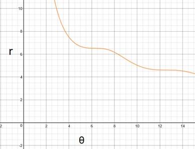

Plotting the relationship ##\sqrt{\frac{2V}{L(θ-sin(θ))}}=r## with θ being the variable, ##V## and ##L## being fixed values, shows a peculiar graph:
There are points in the graph of which the slope is actually zero, which means that a change in θ doesn’t give a change in radius. Looking at the graph as if the radius is the variable (which is my initial question) thus says that there are values of ##r## in which the change θ is vertical, as if it means that the radius ##r## doesn’t need to change to make θ change. I’m not sure how to interpret this.
How is this possible if the length ##L## and the volume of the liquid ##V## are fixed?

##\theta## is only meaningful up to 2 pi, the first point where the derivative goes to zero. Your cylinder is nearly filled close to this value, increasing the radius a tiny bit leads to a large change in the angle, with a diverging ratio where the cylinder is exactly full.
There is an angle that minimized the area for a given volume. Here is a plot.

Ah, can't believe I missed this. Furthermore, shouldn't ##\theta## only be meaningful up to ##\pi## instead of ##2\pi## since an angle higer than ##\pi## would give negative values? So with the mentioned formula I can only calculate the area up until the liquid is filling half of the circle?
Negative values of what? The sine gets negative, but ##\theta - \sin \theta## stays positive. All your formulas work up to 2 pi. 2 pi corresponds to a fully filled cylinder.

Just checked, and it does indeed work. The truth is that for the picture:
I derived a formula myself first, for the area ##O##, which is:
$$r^2 (\frac{\theta}{2} - sin(\frac{\theta}{2}) \cdot cos(\frac{\theta}{2}))$$
I thought that if ##\theta ≥ \pi##, this formula would give an erroneous area of ##O## since I'm deriving the side lengths of triangles with an angle ##\theta##, and thus an angle can not exceed ##\pi##.
However, it does give correct answers even if ##\theta ≥ \pi## and plots the exact same graph as ##\frac{r^2}{2}(\theta - sin(\theta))##.
But I can't really deduce how:
$$r^2 (\frac{\theta}{2} - sin(\frac{\theta}{2}) \cdot cos(\frac{\theta}{2})) = \frac{r^2}{2}(\theta - sin(\theta))$$
Which means that:
$$cos(\frac{\theta}{2}) \cdot sin(\frac{\theta}{2}) = \frac{1}{2} \cdot sin(\theta))$$
Is there a way to prove this equation?
