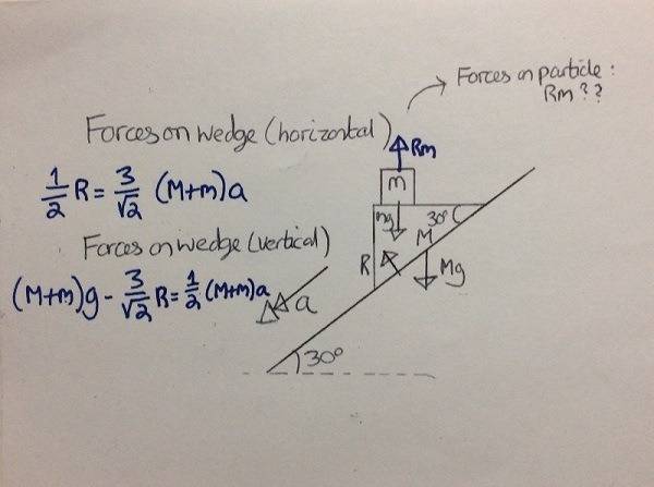

Thank you very much for your response and my apologies for not adhering to the template. Based on the problem description (which was not accompanied by an image) I came up with the free body diagram attached.
Does this look correct? As you can probably see, the main problem is that I'm uncertain as to the acceleration of the particle relative to the wedge. I can see the wedge being acted on by the surface and particle, but no net forces seems to act on the particle. I clearly don't understand the system and would really appreciate some assistance.

Ah, the diagram helps a lot, thanks.
Are they assuming that all surfaces are frictionless? They say the inclined surface is "smooth", but that doesn't necessarily imply frictionless.
If there is no friction between the wedge and the inclined plane, and there is friction between the wedge and the top box/particle, then you are right that the masses would just add. But if there is no friction between the wedge and the top box/particle, I can see that the situation would be changed. The top box would have no horizontal motion as the wedge slipped down and to the left. Can you see how that would change the acceleration of the wedge and particle?
Thank you very much for your reply. As all the earlier exercises in the textbook indicated frictionless surfaces, I assume the same applies here and that there's no friction between the wedge and the top particle. Honestly, though, I just don't understand how the system produces an acceleration of '(M + m)g / 4M + m' in the particle.

Could you use parenthesis to clarify what you mean by this equation? If it's (M + m)g / 4(M + m) I think I know how they got it.

The reasoning was that since the top mass cannot be moved sideways (because there is no friction) by the motion of the wedge, it just translates straight downward as the wedge accelerates down and left along the inclined plane.
So the acceleration of the wedge is (M+m) * cos(60) = (M+m)/2.
And since the top mass only translates downward, I thought that the acceleration downward was half of the wedge's acceleration down and to the left. But there must be more going on here, so back to the drawing board... Have you made any more progress?

I haven't solved it yet, but your your reasoning has generated new impetus and I've now gotten closer to the desired result. I'm going to have another try at getting the actual result, but I might have to resume tomorrow evening as I need to be up early tomorrow.
The best I've been able to come up with for now is the following updated equations of motion (where ##R_{m}## is the normal reaction of particle on wedge):
Horizontal Forces on wedge: ##\frac{1}{2}R = \frac{3}{\sqrt{2}}Ma##
Vertical Forces on wedge: ##Mg + R_{m} - \frac{3}{\sqrt{2}}R = \frac{1}{2}Ma##
Vertical Forces on Particle: ##mg - R_{m} = \frac{1}{2}ma## (acceleration of wedge downwards = 1/2a)
These gave me ##a = \frac{2(M+m)}{19M + m}##, which really sucks. Obviously I'm making a big error but I'll have to look into it again tomorrow.

Suppose you were given the vertical acceleration of the wedge surface; Call it ##a_v##. What will be the normal force ##f_n## of the particle on the wedge? (write an expression for ##f_n## in terms of ##m## and ##a_v##). You should also be able to relate ##a_v## with the downlsope acceleration of the wedge, ##a##, via the geometry.
Then it's a matter of doing the usual block on a slope stuff.

These equations look (almost) correct. Should each ##3/\sqrt{2}## be ##\sqrt{3}/2##?

Talk about embarrassing! Many thanks indeed TSny for revealing my stupid error, which most likely explains the larger coefficient of M mentioned earlier. I'll update the equations and post an update this evening.
I would like to thank you all for your generous and patient assistance, and also apologise for the howler above! Anyway, here are the correct equations:
Horizontal Forces on wedge: ##\frac{1}{2}R = \frac{\sqrt{3}}{2}Ma##
Vertical Forces on wedge: ##Mg + R_{m} - \frac{\sqrt{3}}{2}R = \frac{1}{2}Ma##
##R_{m} = mg - \frac{1}{2}ma##
##R = \sqrt{3}Ma##
##(M + m)g - \frac{1}{2}ma - \frac{3}{2}Ma = \frac{1}{2}Ma##
##\frac{a}{2} = \frac{(M + m)g}{4M+ m}## - particle's acceleration as required

Looks good!
You might check to see if you can work it by replacing the vertical and horizontal force equations on the wedge by just a single wedge equation for forces acting parallel to the plane. (I think this might have been what gneill was hinting at in post #21.)
