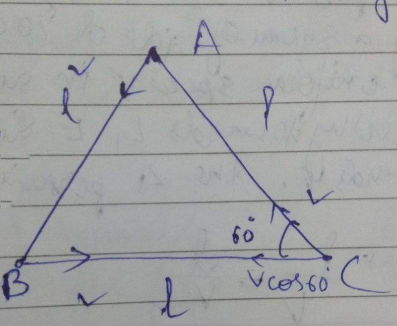

At the corners if an equilateral triangle of side 'l', 3 particles A, B and C are located as shown. At t=0, all the particles start moving with a uniform speed v in such a manner that always velocity of A is heading towards B, B is heading towards C and C is heading towards A. Find the time after which 3 particles will meet
V(A-B) =V(A) - V(B)
Velocity of B wrt C =
(v +v*cos 60) i^ - vsin60 j^
= (3v/2)i^-((3)^(1/2)/2v)j^
But since C is also moving this initial velocity would vary. So how to find a function which defines its path and hence I can find time at which the particles meet. I was told to take rotating frame of reference that would rotate with a magnitude and direction of vsin(theta). That would cancel the (3)^(1/2)/2*v component. But I don't understand how a rotating frame which will cause some pseudo forces to cat on the system would cancel the component perpendicular to the line joining B and C. Please explain
Where is the figure? Also, please write and explain your problem clearly using the mathematics tool available here, similar to ##\LaTeX##. As it stands, I understand very little of the problem you just asked, though it might well be an interesting one.
The figure is just an equilateral triangle and A, B and C are situated at its corners respectively.

What angle is it moving at? Measure that relative to a line pointed at the center of the triangle.
Edit: If you had listened to @brotherbobby in #3, you'd have a diagram ready to help.

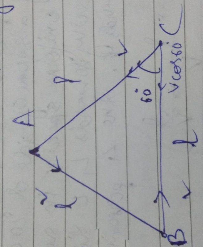

Rotate that image.
So, that's a lower case L representing the initial length of each side. That ##l## doesn't show well in the default PF sans-serif font. The UNICODE character for the script version, ℓ , does look better, but can be hard to find. (See the last letter in my signature.)
Find the center of the triangle, as @haruspex suggested, then, for any vertex, find the components of the velocity relative to the center.
In my opinion, it will also be helpful to use polar coordinates. For this, vertex A is simpler to work with. Get expressions for both the position and the velocity with respect to the center.
