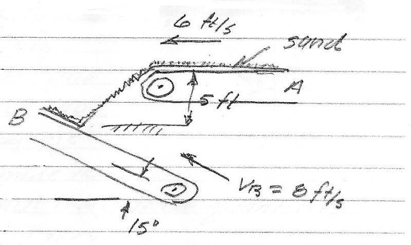

Belt A conveys sand with a velocity of 6.0 ft/s (constant). The velocity of belt B is 8 ft/s (constant). Determine the velocity of the sand relative to B as it lands on belt B. Answer: VS/B=20.1 ft/s at 85.1 degrees
VS/B = VS-VB
(Velocity of sand relative to belt B = velocity of sand as it hits belt B - velocity of belt B)
VB=8cos(15°)+8sin(15°) = -7.727[tex]\hat{i}[/tex]+2.071[tex]\hat{j}[/tex](ft/s)
My trouble is with finding VS. I know that on the horizontal section of belt A, the sand's velocity (VS) is -6[tex]\hat{i}[/tex]+0[tex]\hat{j}[/tex](ft/s).
When the sand hits the bend where belt A is not horizontal anymore, but starts to bend into belt B, the velocity of the sand changes.
I think I'm stuck on the trig of what the angle is and how the 5ft contributes to finding the correct angle that the sand runs into belt B.
when the sand leaves the belt A, its in free fall. use projectile motion analysis to find
the velocity 5 ft below, when it hits belt B.
