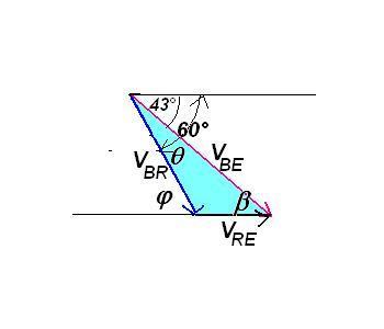

a) Find the speed of the boat with respect to the Earth. (km/h)
b) Find the speed of the boat with respect to the river if the boat's heading in the water is 60° south east (km/h)

You know that the velocities are vectors and add together by components. Taking the positive x-axis pointing to East, and the y-axis pointing to South, the velocity of the boat with respect to the river is V =Vcos(60°)i + Vsin(60°)j, and the velocity of the river is Vr=5.4 i, the velocity of the boat with respect to the ground Vg=V+Vr =Vgcos(43°)i+Vgssin(43°)j. (bold means vectors)
Compare both the x and y components of the vector sum. You get two equations for the unknowns V and Vg.

You wrote: V be = V br + V re
re-arranging, gives V br = V be - V re
Use this relation to determine Vbr components:
i component: Vbe cos 43° - 5.4
j component: Vbe sin 43°
and it is given that tan 60° = (j component) ÷ (i component)
leaving you with one equation in one unknown, solve for Vbe

Have you solved such problems concerning vector addition with the Cosine and Sine Laws?
Yo can find the angles of the shaded triangle in the picture.
