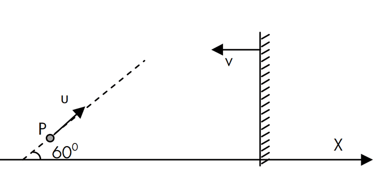

A particle P is moving in a straight line with velocity u=10 m/s along the ground. Its line of motion makes angle θ=60° with the X axis drawn on the ground. A flat mirror oriented perpendicular to the ground as well as the X axis is moving with constant velocity of v=20 m/s. This velocity is directed parallel to X axis from right to left. Calculate the relative speed (in m/s) between the particle and its image.
VA with respect to B = VA - VB
The velocity of particle is 10m/s , and angle is 60°. So the velocity in terms of unit vectors is 5i + 5√3j. But since the image will be traveling in y direction with the same velocity , and we want to find relative velocity , we need not consider the y direction . ( Is that correct?)
Now in x direction , I've a few problems. First how to calculate the velocity of image ? My friend told me that it is 2m-o ( where m=velocity of mirror and o = velocity of object ( in this case particle ) ) . Is that right?
So velocity of image is = -40i-5i=-45i ( since v. of mirror is -20i) .
Now Velocity of image with respect to particle is v= -45i-5i = -50i .
So relative speed is 50 m/s.
But the answer is wrong.
Please help me.

x component of particle motion is certainly LESS than the 10m/s total velocity and mirror motion is 20m/s in x direction, so how could you POSSIBLY get a combined velocity of more than 30m/s?
What's with the "i" and "j" stuff? Just get the x component of the particle motion.
Yep, correct.
I don't see how your friend arrived at that relation.
Anyways, to solve the problem, work in the reference frame of mirror first. From there you can find the velocity of image wrt mirror.

So velocity of particle with respect to mirror is -20-5 = -25 .
Also the velocity of image with respect to mirror is then 25 ( I.E. in opposite direction to that of velocity of particle with respect to image ).
So Velocity of particle with respect to image is -25-25=-50 .
So again I get the relative speed between particle and image as 50 , Where I went wrong ?
Please help .
Correct! :approve:
Remember, you are still working in the reference frame of mirror.
You have the velocity of image in mirror frame. Can you find the velocity of image wrt ground now?

You have ##\vec{v}_{\text{image wrt mirror}}##. This is equal to ##\vec{v}_{\text{image wrt ground}}-\vec{v}_{\text{mirror wrt ground}}##.

What are the direction of velocities? ##\vec{v}_{\text{image wrt mirror}}## is towards left. What is the direction of ##\vec{v}_{\text{mirror wrt ground}}##?
The direction of Vmirror wrt ground is also towards left.
Taking towards right as positive -
-25 = Vimage wrt ground - ( -20)
-45 = Vimage wrt ground
Am I finally right ?

VParticle wrt image=Vparticle - Vimage
VParticle wrt image= 5-(-45)
So , VParticle wrt image =50
And... this is a wrong answer. ( And same as the one in my attempted solution in original first post ).
Where have I went wrong ?

Draw a picture showing the position of the object, mirror, and image at some instant of time. If you want, let the distance from the object to the mirror be, say, 60 m at this instant. Note how far the image is from the object.
Now redraw the picture for a time of 1 second later showing the new locations of the object, mirror, and image. Determine from the picture the new distance from the object to the image.
So, you can see how much the object-image distance decreased during 1 second of time.
