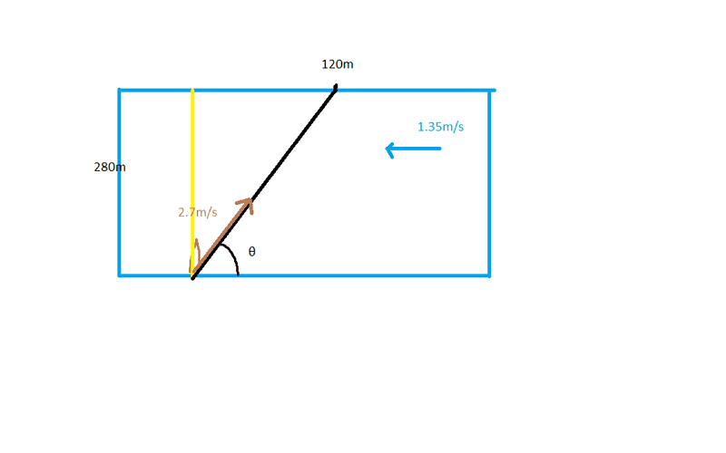

In the picture wouldn't the 120m distance be the whole horizontal distance? I am bit confused on that.
120 m is the distance along the river where the boat is due.
ehild

That 120 m is the distance on the other side of the river from the point opposite to the starting point.
ehild
ehild
so 280 is horizontal distance then
280 is the width of the river. if there was no current, and the boat wanted to go straight across the river, it would have to travel exactly 280 m. In my (horribly drawn) picture, 280 is the vertical distance, or the y component of the displacement.

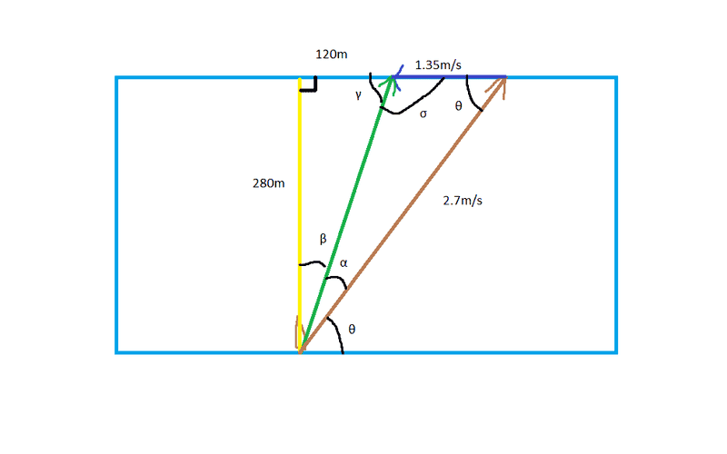

Here's the solution that was explained to me, using another horribly drawn ms paint picture as a guide.
The yellow line is straight across the river, green line is where we want to go, brown is where we have to aim, dark blue is the velocity of the water. Since we know the length of two sides of the right triangle, we can find the angles. tanβ = 120/280. so β=23.2° and γ=66.8°. Since we know γ, we can find σ= 113.2°. Then use law of sines to find 2.7/sin(113.2) = 1.35/sinα. α=27.4. 90-β-α=θ=39.4°. Which matches all previous attempts.
I personally didn't care for this method because I'm mixing angles involved with distance with those using velocity. My initial intuition would be to not mix the two, but this seemed to work out.
