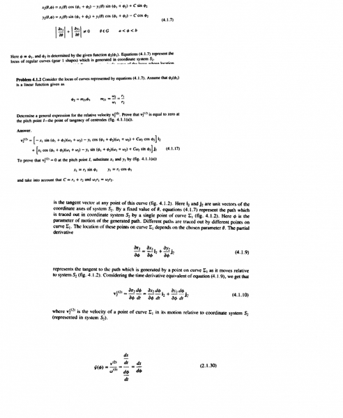

Hi Folks,
I am struggling to see how eqn 4.1.17 is arrived at using using eqn 4.1.10 at bottom of attachment. Its not clear to me what [tex]\frac{d \phi}{dt}[/tex] is...apart from what is given in eqn 2.1.30...
Any ideas?
Thanks
I have an idea ... post a pic that can be read

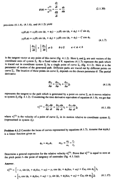

Hi,
This is the best I can do regarding a readable picture where I have pasted the relevant eqns.
