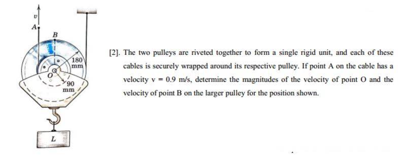

In summary, the homework statement is as follows: Two pulleys are riveted together and a known velocity is applied to them. I need to find the velocity of two other points.
bkw2694
33
As shown in the picture, two pulleys are riveted together with a known velocity. I need to find the velocity of two other points.
V_A = VB + <ω> x <BA>
V = ωr
I've honestly been trying to figure this one out for over a week, and I'm sure I'll kick myself when I realize how easy it is, but I'm trying to solve by:
V_A = (r_OA)*(ω_OA), using V_A = .9 m/s; r_OA = 90mm, which gives me ω_OA = 10 rad/sec (which I assume ω is equal on the entire pulley since it's riveted together).
Then I used the relative velocity vector formula for A and O:
V_A = V_O + <-10 rad/sec k> x <-.09 m i>
which gives me: .9 m/s j = V_O j + .9 m/s j. Solving with this gives me V_O = 0, which is incorrect. I tried solving for B the same way.
The actual answers are V_O = .6 m/s, and V_B = .849 m/s.
Thanks in advance!
bkw2694 said:
V_A = (r_OA)*(ω_OA)
This would give the speed of A relative to O, not relative to the earth.
Likes bkw2694
I thought <w>x<OA> was the speed of A relative to O? I thought the equation was sufficient for finding the actual speed of A? How would I solve for thespeed relative to earth?
Yes, it's the speed of A relative to O. But point O is not at rest relative to the earth.
How would I solve for the speed relative to earth?
Can you find a point of the pulley that is instantaneously at rest relative to the earth? Hint: Think about problems where you have rolling without slipping.
Likes bkw2694
TSny said:
Yes, it's the speed of A relative to O. But point O is not at rest relative to the earth. Can you find a point of the pulley that is instantaneously at rest relative to the earth? Hint: Think about problems where you have rolling without slipping.
Ahhhh, I see now. So I just plugged V_O = .18w into the equation and solved for w first. Thanks so much!
OK. Or, you can get ##\omega## from ##V_A = .27 \omega##, since ##V_A## is given.
Likes bkw2694

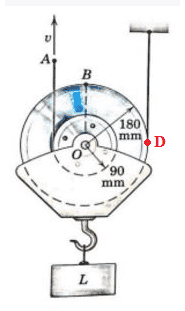

I see that that definitely works mathematically, but I don't understand why it works by looking at the problem. Why is it .27 instead of .18? I don't understand why the distance is .27 when the velocity vector is .18 m away.
Thanks again!
Let point D be the point on the outer rim of the pulley where the string on the right meets the pulley.
Use the fact that ##\vec{V}_A =\vec{V}_D +\vec{V}_{A/D}##.
It might help if you consider what happens to a simpler situation where a string raises a single pulley
with one end of the string attached to the ceiling.
In the given problem you have:
V0 = .18 * w where w is the angular velocity
VA = V0 + .09 w
and this is easily solved for w, the angular velocity.
