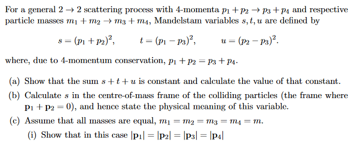

Stuck on (c), part (i). Any ideas about what is the most elegant way to prove it, maybe using Mandelstam variables since this exercise is supposed to be about them?

Unless you assume the CoM frame, then how can that equation hold?

Are you suggesting this as an hint on how to prove it, or are you suggesting that the question is wrong?
I guess you have to assume the CoM frame, otherwise ##|\mathbf p_1| \ne |\mathbf p_2|##.
Do you see how to show the full equation in that case?

Yes, with the extra assumption that ##|\bf{p}_1| = |\bf{p}_2|## I can solve this. Let’s call ##\bf{p}_i := \bf{p}_1 = \bf{p}_2##. Then, ##\bf{p}_1 + \bf{p}_2 = 0 = \bf{p}_3 + \bf{p}_4## implies ##|\bf{p}_3| = |\bf{p}_4|##, and we can also call either of these ##\bf{p}_f##. To get our result we just need to show ##|\bf{p}_i| = |\bf{p}_f|##. But this follows from conservation of energy:
\begin{align*}
E_1 + E_2 &= E_3 + E_4 \\
2\sqrt{m^2 + |\bf{p}_i}| &= 2\sqrt{m^2 + |\bf{p}_f}| \\
|\bf{p}_i| &= |\bf{p}_f|
\end{align*}
However the text doesn’t make the assumption that ##|\bf{p}_1| = |\bf{p}_2|##. Do you think it’s not possible to show it in a general case? Is the question wrong?

It can't hold in the rest frame of either particle!

In the center of mass frame that is true by definition, as part (b) of the problem says. Part (c) apparently wants you to continue to assume you are in the center of mass frame, as in part (b), but doesn't say so, which it should for clarity.

You’re right, that was easy to check in hindsight. There’s at least one other frame where the process can happen with all equal masses, yet that relationship doesn’t hold. Thanks for your help!

I think problem c wants you to use the center of mass frame just like it did in (b).
