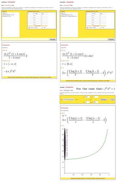

Mentz114 said:
Part 2.
I did the calculation in (1+2)D and found the sqare of the energy reaching the circle is invariant.
If a point source of light is at the centre of a circle, and moving at velocity β wrt to the circle. The square of the energy falling on a unit element of the circle in unit time is proportional to
[tex]
h^2\nu^2\frac{1+\beta\cos(\theta)}{1-\beta\cos(\theta)}
[/tex]
where θ is the angle between the light ray and the direction of travel. To get the total we integrate for -∏ < θ < ∏ and multiply by 2. I get 4∏h2v2 which is independent of β.
Maybe someone can extend this to 4D ?
[edit]Spherical symmetry means we can just integrate the great circles of the sphere to get the same result in 4D. viz, energy flux through the surface of the sphere is independent of β.
Your integral does indeed work for (1+2)D http://www.quickmath.com/webMathema...(1+b*cos(t))/(1-b*cos(t))*2&v2=t&v3=-pi&v4=pi
For (1+3)D, I only have to integrate from 0 to pi, but I will have to multiply it by a weight of 2*pi*sin(θ) (the circumference at θ) before integrating.
[tex]
h^2\nu^2\frac{1+\beta\cos(\theta)}{1-\beta\cos(\theta)}2\pi sin(\theta)
[/tex]
http://www.quickmath.com/webMathema...(t))/(1-b*cos(t))*2*pi*sin(t)&v2=t&v3=0&v4=pi
[tex]
h^2\nu^2\left(2 ln\left(|\beta+1|\right)/\beta-2 ln\left(|\beta-1|\right)/\beta-2\right)2\pi
[/tex]
http://www.quickmath.com/webMathema...x-2*log(abs(x-1))/x-2)&v2=0.0&v3=1&v4=0&v5=40
The chart has a floating point error near the y-axis of the chart. It also has the sign wrong.

Regardless of the floating point errors where higher precision is demanded, it is clear that the integral of [tex]
[/tex] is by no means a constant.
